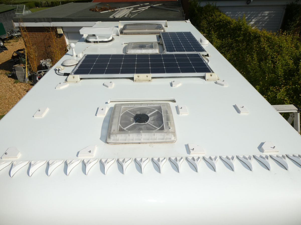

I recently fitted a couple of semi flexible panels on our van, but was thinking ahead in case they needed to be removed, plus I wanted ventilation under the panels as they get hot, so I made mounting blocks which I bonded to the roof and then bolted the panels to the mounting blocks.
Might be worth thinking about when you come to fit your replacement panel.
That looks really neat. Are the blocks to the van roof only bonded and not not screwed? My problem is that the flexipanel is fully bonded to the roof of our van so it is a big area to debond but I'm not sure I would be confident enough to refit and only use bonded blocks.
Believe me those blocks are going nowhere, they are bonded to the roof with Sikaflex 292i marine adhesive which is what they glue parts to ocean going racing yachts with.

Semi-flexible panels would not of been my first choice, but being borderline weight on our back axle and with no viable space on the roof at the front of the van, the only real option was right at the back end on the overhang which meant adding yet more weight on the back axle.
I bought the panels after a conversation with the supplier in which I asked and he explained that with these panels the backing used was chosen to minimise different material expansion rates and the cell connections were wired so that if a cell connection failed you would only loose a line of cells and not the whole panel and the cells were divided up into multiple lines, also the panel covering was ETFE which is a self cleaning material. The semi-flexible panels I fitted are 80 watt panels and weighed in at 4kg for the pair compared to 13.5 kg for rigid panels.
Having deciding on semi-flexible to save weight, this now threw up the problem of mounting the panels.
Our van roof is of the floating skin type with the aluminium skin being only 0.5mm thick, so I was not comfortable with the prospect of trying to remove a panel bonded direct to the roof skin if the panel failed at some point, plus I wanted airflow under the panels to aid cooling and panel efficiency.
The panels bolted to raised mounts addressed both easy panel removal and air space under the panels.
Since take the photos, I have added an additional mounting block at the centre of each of the panels which is taller than the edge mounting blocks, for two reasons.
Firstly, being just fixed at the edges, the panels naturally drooped in the middle, which allowed water to settle in the middle when parked up. With the taller mounting block at the centre of the panels, the water now runs off the panels, and secondly, the centre mounting block now tensions the panel which should help to reduce the Rolf Harris' wobble board effect.
Time will tell if this was a great idea or a disaster waiting to happen ....................... watch this space.
