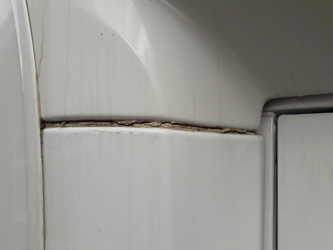

I wanted to seal the joint on the top of a panel, to stop the water dripping down inside. After some research I chose Hodgsons Seamseal CV, which is a none drying, bedding sealant. It has cracked up and looks dirty

You want a PU sealant that will set for that application, one of the SIKA range or the one that Terry recommends is it Puraflex?
Make sure to clean out all of the old non setting mastic.

The other option I had looked at was Carafax Caraseal IDL99.
I was once recommended by a caravan mobile mechanic, The Works sealant from B&Q and other places
Plumbers gold .is great stuff just my option it's as good as sikoflex. But half the cost ..
