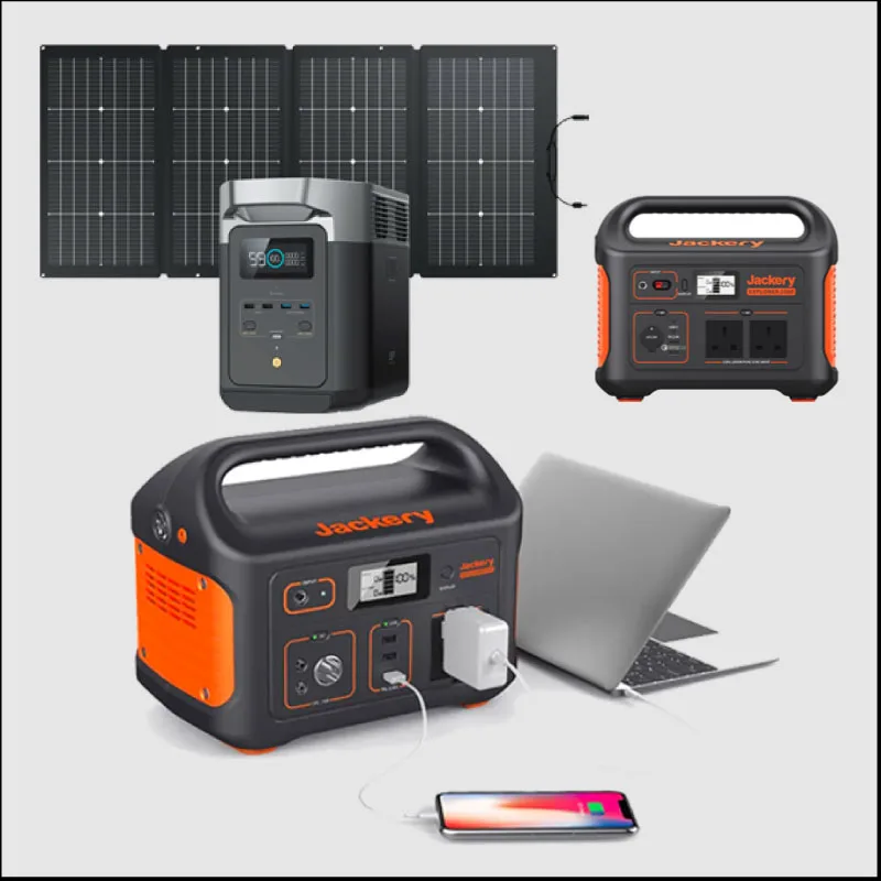

Her's my take on the popularity of these, natty Jack/Blue/Eco things
Some will agree plenty won't, let me know your use-cases below and I'll update the article with any good ones (y)
