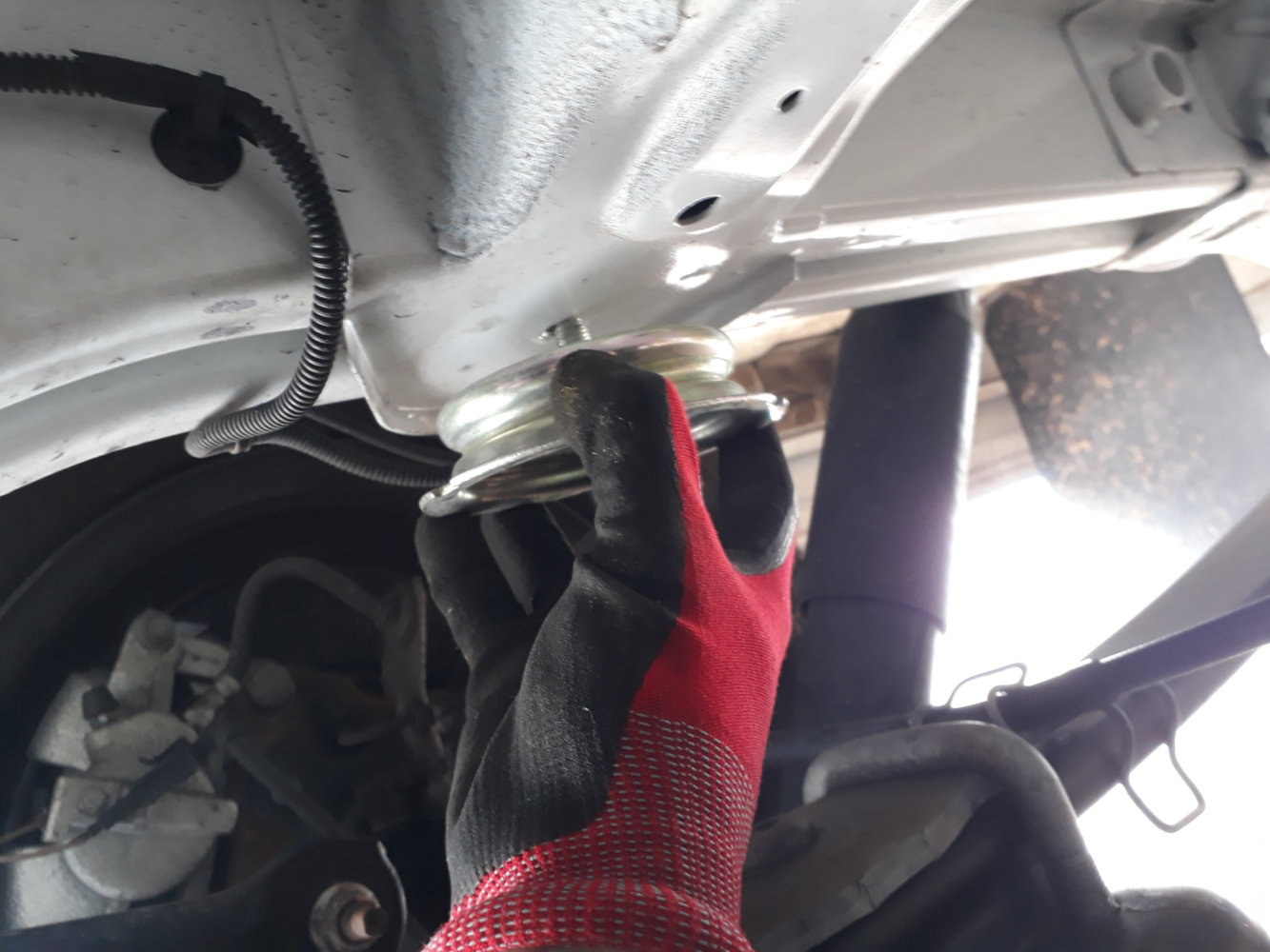

When you took off your bumpstops, did they slacken quite easily?

The bump stops (aka Aeon Springs which form part of the suspension) are easy to take off. If you use some grippy gloves then you'll simply twist from side to side and off they come. The supporting plate that retains the bump stops cannot be unscrewed by hand so you will have to get a chisel and hammer and insert the chisel into one of the grooves before hitting it ant-clockwise. It won't take much and then you can unscrew the rest by hand.
When you get your kit then make sure you don't remove the white PHTE tape which comes with the bellow valves. Some people remove it by accident and then wonder why they have an air leak from the top of the bellow:D
The addition of the semi-air system will certainly help counter a heavy rear end but do try if you can to put more weight on the front as you want to avoid light steering issues.
My axle ratio is 1,620kg to 1,900kg and with semi-air fitted it rides really well now but, I've got to admit, that upping my rear axle to 2,240kg would potentially unbalance things a bit. Once you have fitted your kit then it may be a good idea to run your suspension at 3-bar pressure and then adjust it thereafter. I think you will need 3-bar minimum with a 2.24T loaded axle.

Thanks for your info Andrew, just to update, have now completed the uprating. I found the easiest be way was to remove the rear wheels, one side at a time and fitted everything without having to get under the van. So much easier, especially as I don't like working upside down underneath vehicles any more. Van now sits in such a way that you can slide your hand between the top of the tyre and the side of the van, whereas before the top of the tyre was hidden behind the side.
I won't lie to you Dave, it was quite fiddly at times. The procedure itself is OK but the fact that you are scrunched up on the floor is a bit of a pain. The Pilote has great ground clearance but it's still not lavish for this type of job. The same goes for the plumbing of the twin lines as they need some thought and again you need to be scrunched with your gear immediately at hand.
Once you pull the bumper stop off and then dislodge the bumper stop housing with a mini sledge hammer and chisel then you're away. You then need to move the handbrake cable and then add the bellows before finishing off with the securing bolts. Here are a few pics I took:
