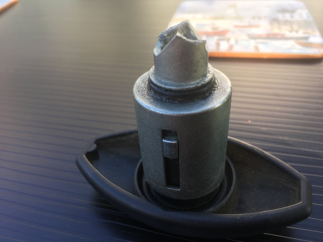

All the parts are replaceable. I had one shear off earlier this year as I turned to close the lock. Mine had an alloy casing which fatigued due to wear and tear. I regularly check mine now and if they feel stiff when turning I use graphite powder in the barrel and a little oil around the mechanism. The lock barrels are removable with the correct tool. Mine was broken so an expense from Hymer Germany to have the barrel replaced.

Ours has snapped off at the end where it is weakened by the slot machined in for the pin.
I was hoping to be able buy that part rather than the whole lock, our barrel is fine.
We were away at the time staying at Cornish Farm in Somerset having a Strikeback Growler fitted with VanBitz. I had just finished setting up, turned the knob to close the locker and it just fell off.
I got in touch with Travelworld who kindly couriered the replacement parts
overnight to me. I refitted the broken catch the next day so we could close the locker and secure it for traveling.
The actual lock barrel should be able to be removed with the correct tool and refitted in the new lock. My problem being I didn’t have the correct tool, so after viewing a YouTube tutorial though I would improvise with my own made up version - wrong! Unfortunately I ended up buggering the lock barrel so had to order a new one from Hymer Germany via Travelworld that matched my key. Took about 4 weeks to arrive
I am pretty sure any MH dealer or someone like LeisureShopDirect will have replacement parts, the twist push lock handles are universally used by most manufacturers.
