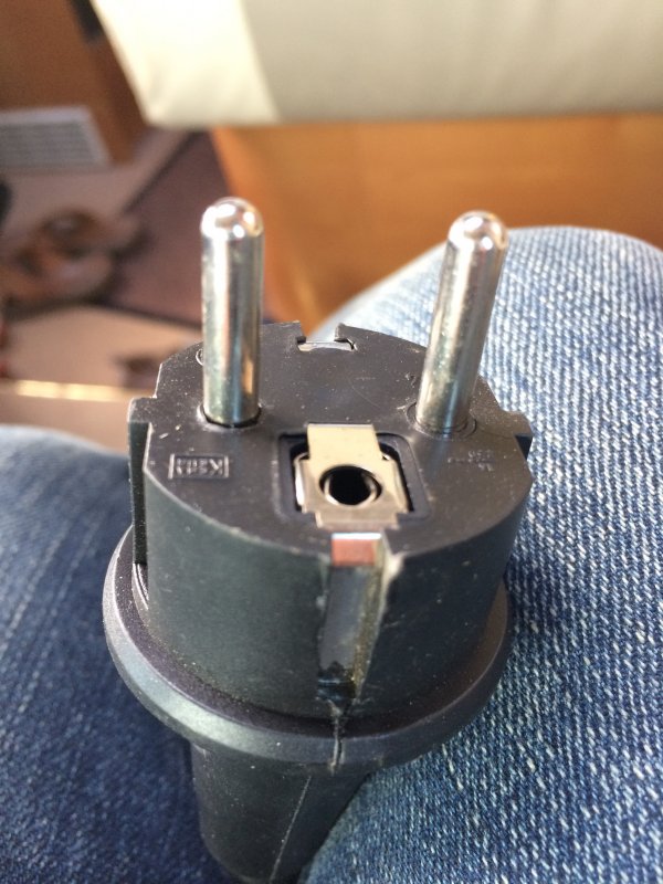

Hi we are in Granada. Spain and have no earth into the van. Tried changing polarity etc but still no earth. Is here anything to make it safer. Thanks Sue
Note: This feature currently requires accessing the site using the built-in Safari browser.
They are two pin but still have an earth contactwith only a 2 pin connection I presume there can't be an earth, I have used them for years while abroad without thinking of any issues, along with millions of others, it surely cant be dangerous![]()
