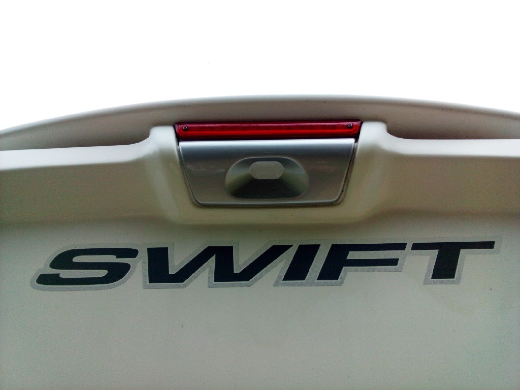

Apologies to the OP for hijacking the thread but I would like to ask @DanielFord what make / model of reversing camera he fitted. I have been trying to find out what camera would fit neatly into the housing on our van shown in the photo.
Thanks.
Paul
Thanks.
Paul
Yeah, I probably worded that badly, we still have the original camera installed, it is a perfectly good unit. What isn't so great is the mirror screen that Swift give you. I purchased a larger monitor, and fitted it to the dash. Easy job, it just plugs into the AV plugs in the video controller. I now get a good picture on the screen that is usable! :D
