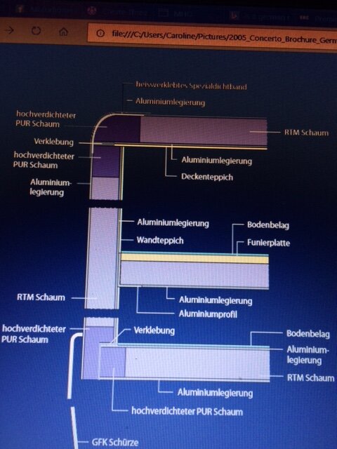

Malibu is same construction with GRP roof & underfloor, difference is that internal walls are finished in wallboard rather than aluminium.
see image below from the Malibu website
Hope this is helpful.

TenBobdave - thanks for photos - but which one shows/describes wallboard not aluminium? I dont doubt you - and its very good to know - Though we have now bought the Malibu coachbuilt - (so too late for wallboard to put us off) we had to sell our Carthago 2 years ago and the price of them is now off the wall !- we were very impressed with the quality of the build so if these are half as good that will do us -

Hi, thanks for your message, the image was to show that the construction is the same as the Carthago,

Just a thought though - The Malibu water ingress warranty states that the vehicle has to be subject to water sprinkled for 20 minutes (same as Carthago) and visual check after - If its wallbaord and not Ali - then wouldnt a damp meter be used? as the wallboard would retain moisture?
The Carthago damp check is as you described as you can't get a reading from a damp meter on the aluminium walls,
The Malibu however having the 'traditional' wallboard inside can be checked with a damp meter in the normal way.

Carthago/Malibu use RTM hard foam which is a bit better than the PU Hymer use, also Hymer internal walls have been Aluminium for quite a few years now.
So the Malibu uses the equivalent PUal 1.0 system, the Carthago shares the PUal 2.0 system for reference.

Can confirm Malibu use aluminium/rtm/wallboard side walls, grp/rtm/wallboard roof and grp/rtm/grp floor. Gas locker door is aluminium/rtm/aluminium due to the openness of Carthago / Malibu gas locker wallboard would be no good in this environment, side locker and under floor locker door and walls aluminium/rtm/aluminium.
