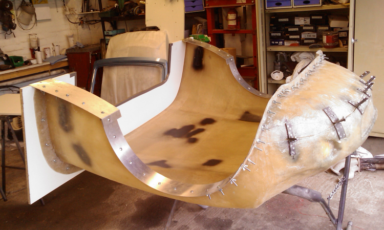

I used to make fibreglass moulds and produce small runs of fibreglass bodies cars.
It may well be quicker and easier if you can to cut and modify an existing shower tray to suit your needs and then produce a buck mould to make the finished article from your buck.
