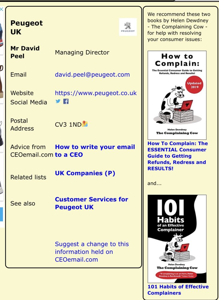

I would go straight to the top. I have just screen shot the attached details of the Peugeot CEO for the U.K. Write a polite and factual email detailing all the facts. I generally put what should have happened, what actually did happen and what I now want / require to happen. Make it Peugeot’s problem, not yours.
I have had some excellent results when contacting CEOs, though no experience with Peugeot.
Good luck,
Lorraine
