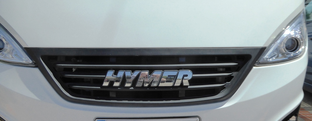

How long did it take you to move the steering wheel, gear knob and pedals. Thinking about doing that to my van so my wife can drive instead of me (y)
I would complain you have been sold a duff van, proper German vans always come with the steering wheel on the left & a driver's door.:LOL:

It's nice to see that people are copying the Globecar owners with their 'meshing' and other mods.:D
No copying:D2 Been meaning to do it since I had the van then a couple of weeks ago my mate gave me a grill.
Our Carthago came with mesh already on ... ours must be superior to your Hymer Lenny, probably because its RHD! :rofl:

That's to stop immigrants hopping under the bonnet at Calais. :ROFLMAO:
And there was me thinking it was a way of making chips easily by throwing peeled spuds at it! :LOL:
