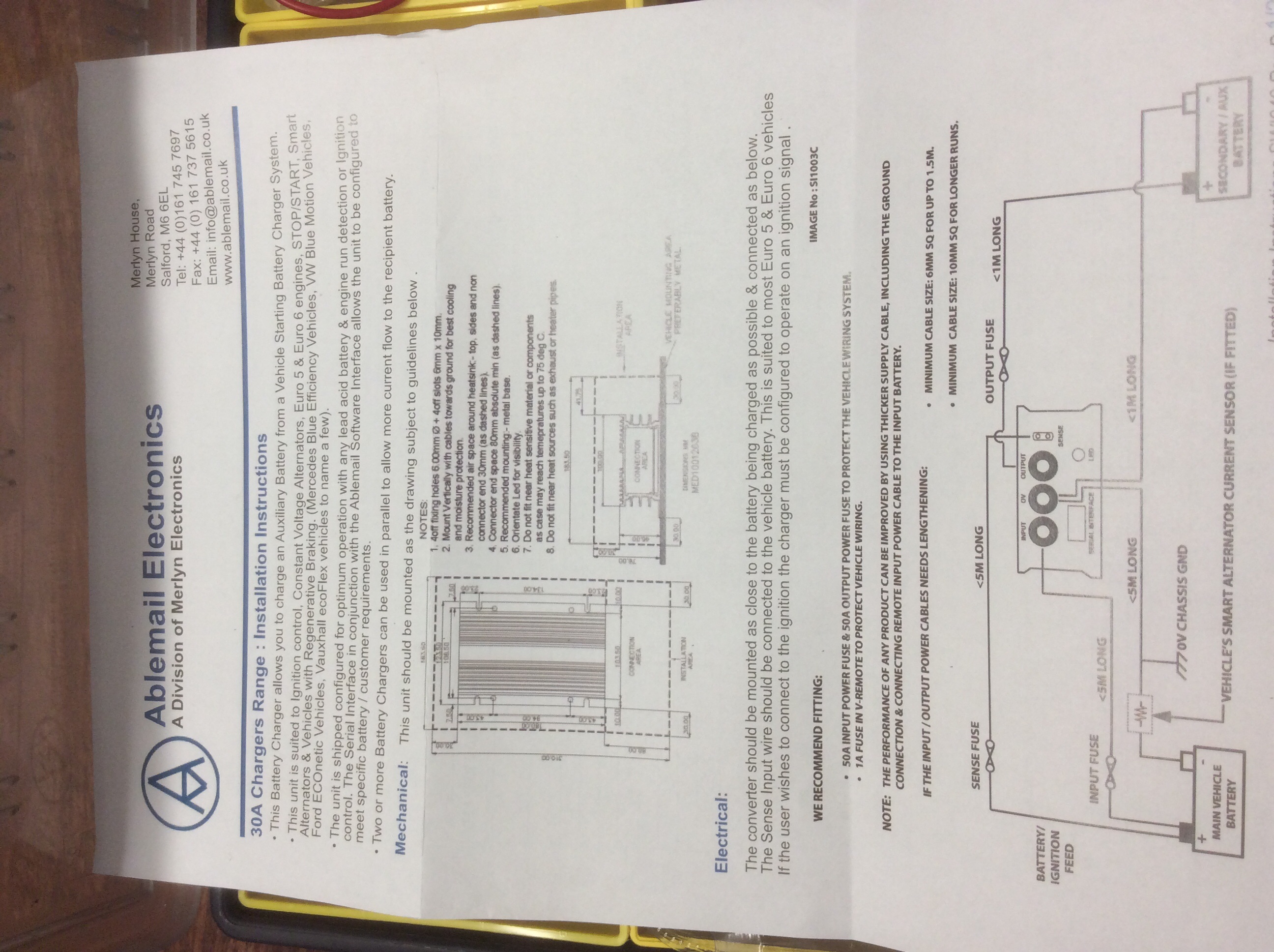

I have just fitted a 30amp B2B on our Iveco based Carthago the van comes standard with a 16mm sq supply to the rear where the Cbe distribution DS470 board is this would normally supply up to a 50amp charge for the std batteries.
As I have fitted a lithium 300amp I thought a 30amp B2B would be a good starting point as to keep well within the limits of a 16mm cable.
So all fitted started up and bingo 30 amp charge going in at 13.5 v to the lithium 14volts supply from alternator, then alternator drops to 11.9 for 10seconds then back up to 14volts and keeps changing every 10-20 seconds.
When I check the voltage at the engine end it reads the same so not a voltage drop on the cable.
Apply a few revs and the voltage stabilises and the charger stays on with no fluctuation,
Could the alternator have a current limitation when running slow.
I have used the D+ to switch the B2B on and off and also a 40amp relay from LB to supply the Cbe for van electrics.

Is it a smart alternator? If you have a shunt on the negative starter battery post it’s a smart alternator. Your B2B should be of the chassis so the shunt can account for the current, and feed the right info to the ecu to control the alternator.
It’s a 2018 Iveco and when I asked at Iveco dealer they said it should not be, but if it was just pull the lead from the - post on main battery
Not from the starter post, have a look at the starter negative cable, if it has a shunt, then ALL your charging and loads ( negative side) should be from the chassis. Usually there is studs power take of under bonnet for this purposes.

Ok had a look this morning and yes there is a shunt on the negative terminal now disconnected but the alternator voltage still fluctuates on tick over up the revs slightly and the voltage stabilises in the vehicle and the B2B stays on
Sounds normal, ecu controls the alternator. Once demand increases, so the alternator output.
I have just spoken to someone who fits this type of b2b on Ivecos and has had similar results on tick over also the manufacturer says it will be the alternator and switching on and off can’t damage the unit.
