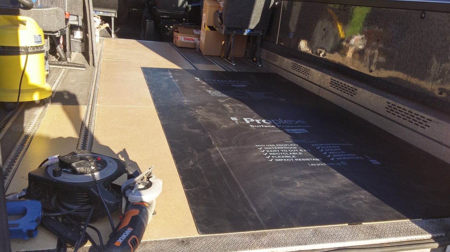

Made a good start on the floor, Unwin tracking is next to impossible to remove so filling the gaps with hardboard (glued and nailed) to level then I'm going to cover with these waterproof/insulating sheets from Wickes then top with 8mm ply as a base to begin building

are you not insulating the floor? 25mm celotex cut to cover the track then a plywood floor. will be cold in winter otherwise
No, i don't want to raise the floor level any more than i have to as head height is just right. Not really planning winter use but it has an eberspacher night heater blown air system that's really warm plenty enough for spring and Autumn use. Its so high I can get to most of the floor from underneath so if i find its not sufficiently insulated i can put some there. :cold:

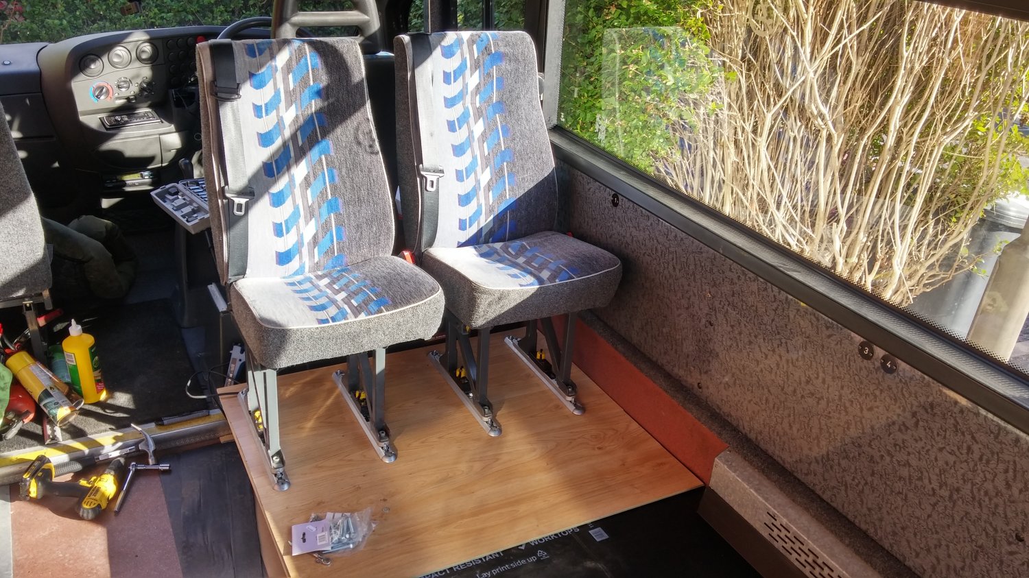

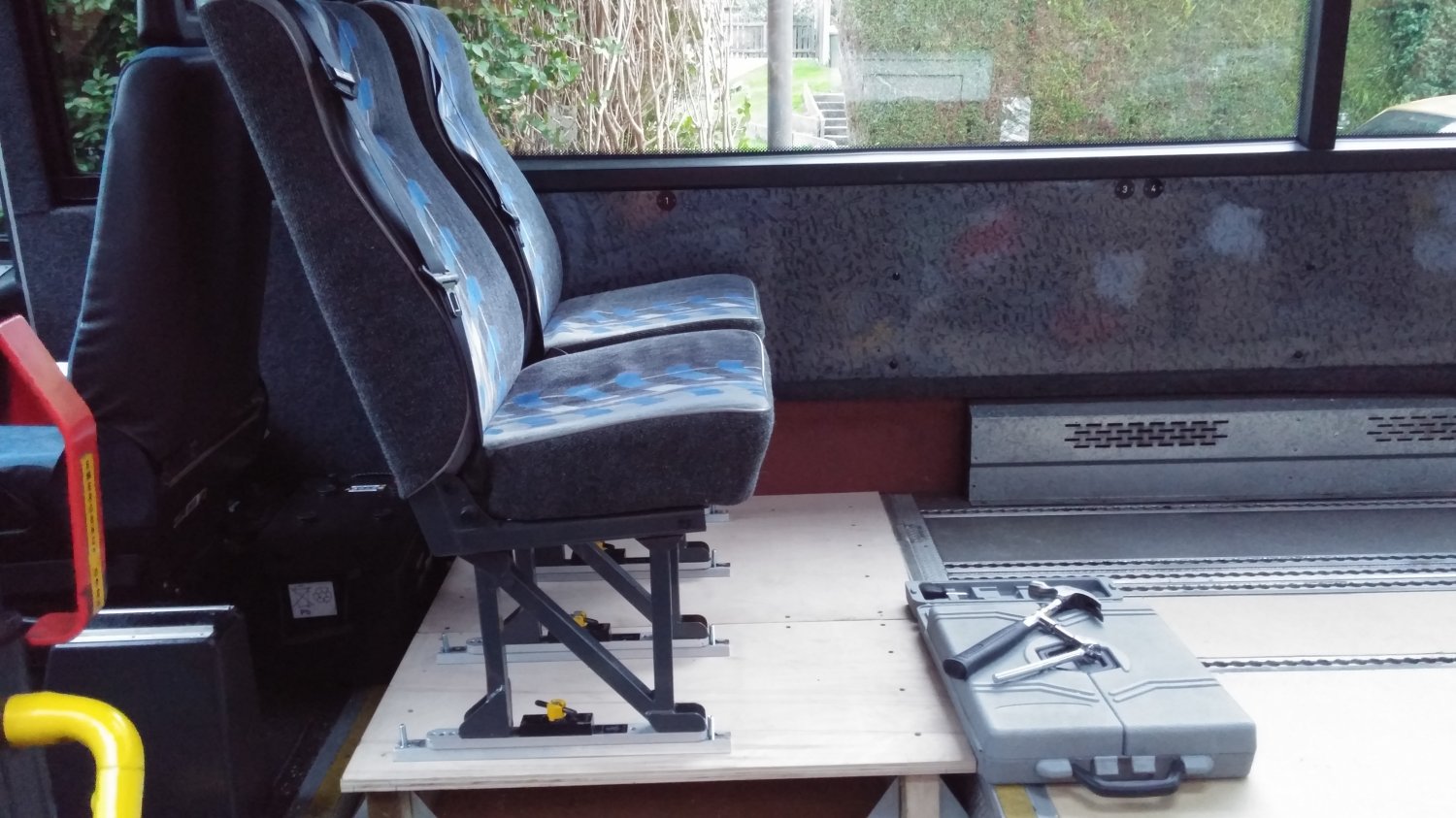

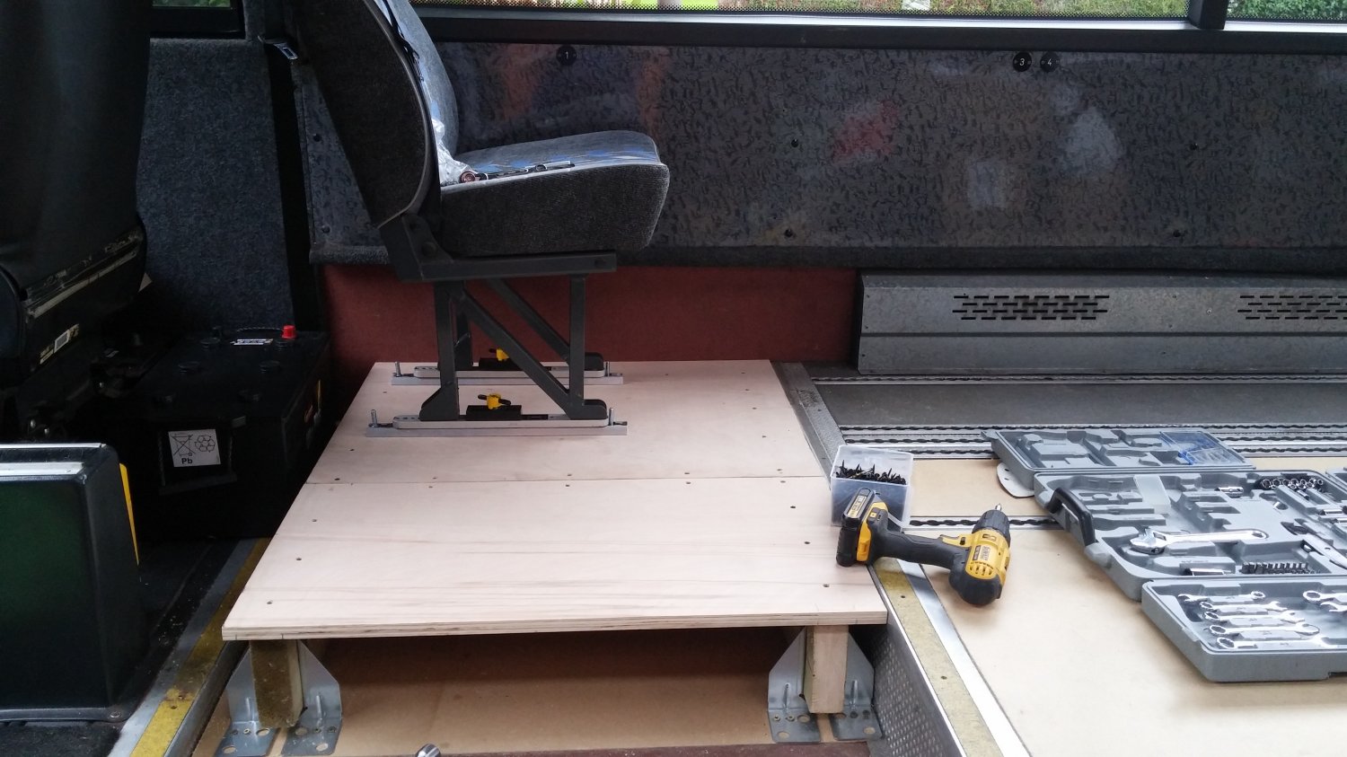

Building up the floor level to accommodate the table and 4 seats, I've used galvanised heavy gauge steel joist hangars (upside down) and pressure treated 150mm joists to raise by 175mm
Finished the raised floor with 18mm hardwood ply, it's rock solid and I'm very happy with the result. Start fitting the seats, bolted Unwin tracking to the new floor with M 8 bolts with steel spring washers, the bolts still need to be cut to size
Second seat fitted and bolted up before testing, very happy, all solid but will have to undo them to put final layer of 9mm hardwood ply on tomorrow

Floor boarded out with 9mm hardwood ply on proplex insulation then more proplex as underlay for the laminate flooring. I decided to finish the area under the seats so i could bolt them up permanently as i was concerned about the protruding bolts getting damaged
insulating and boarding the rest of the floor, looking great
