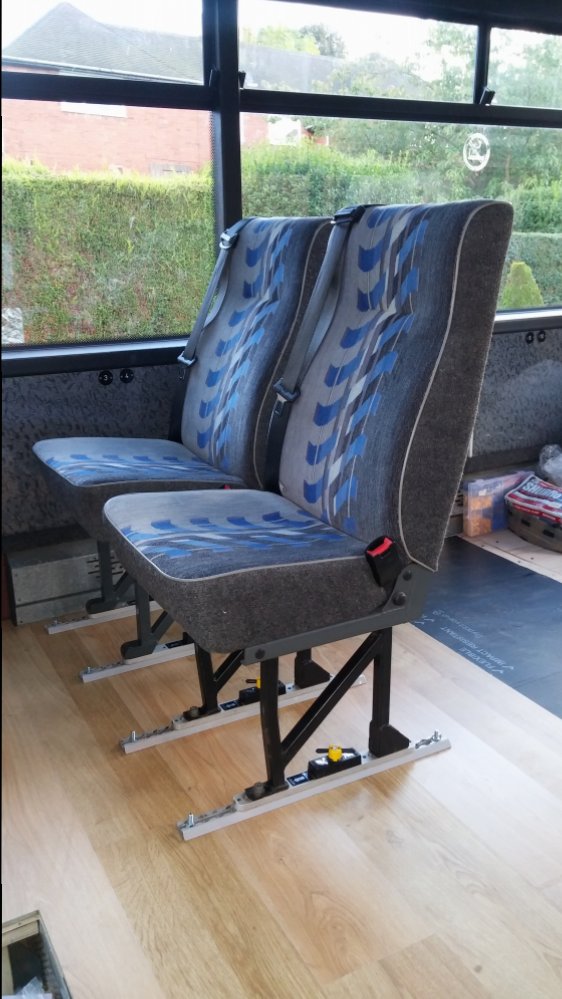

Got the other two dining area seats fitted, just need a table to complete this area, will recover the seats at a later date

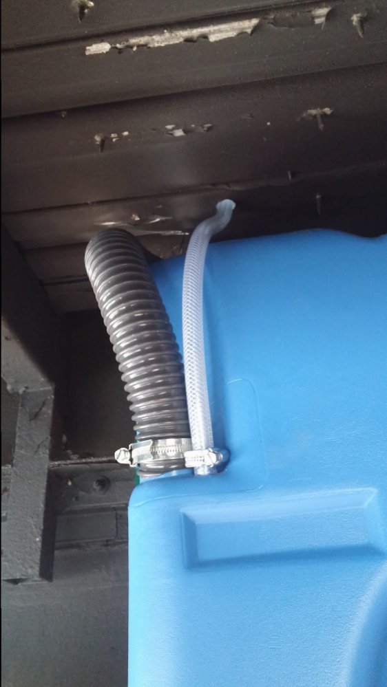

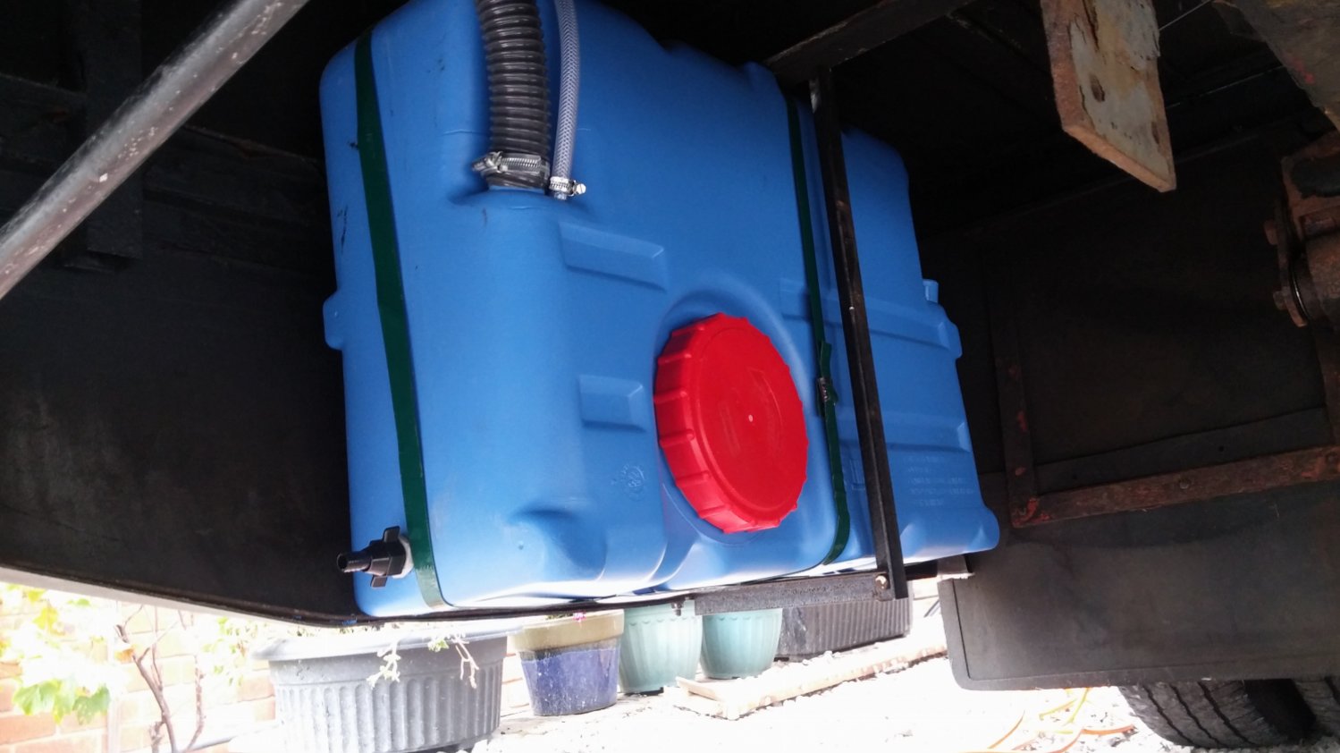

Got the fresh water tank fitted today, its underslung, went for fiamma 70litre and am impressed with the quality although I'm thinking of fitting another breather tube nearer the top as the supplied version seems too low down to allow filling to the top. Didn't get time to fit the lockable filler as it took ages to drill through the floor due to the amount of unwin tracking in this area, need to invest in better quality holesaws for sure :rollingeyes:
The green banding is powder coated 'band-it' stainless steel banding each piece has a breaking strain of 450kg and is through the chassis.:whatthe: The finished result is nice and solid, although I've yet to put a strip rubber between the tank and bracket to guard against noise/chafing.

Got the fresh water tank fitted today, its underslung, went for fiamma 70litre and am impressed with the quality although I'm thinking of fitting another breather tube nearer the top as the supplied version seems too low down to allow filling to the top. .
That's because you've mounted the tank 'on edge' rather than on its base. The cap is meant to be at the highest point . Then the filler & overflow are at the top. As it is the filler will also only fill to the point where it is connected, halfway roughly.To continue o use it like that you will have to install a new filler & overflow right at the top & blank the existing ones.
Mounted in accordance with the instructions that came with it actually :wait:

Just can't see how it can fill past half way ish with the inlet that low ? :unsure: I'd be thinking either the tank is wrong or the instructions are ?

Water will find its own level, but will fill more slowly due to the pressure when it reaches the fill connection.. Moving the breather pipe to the top will help.

but if the water level is above the inlet, which you are trying to do, it will then come back out. Water level can only be as high as the inlet.
If you did fill it to the top having put in a higher level breather , then as soon as you take the hose out it will pour back out & find its natural level at the filler inlet.
No - the filler is well above the top of the tank.
