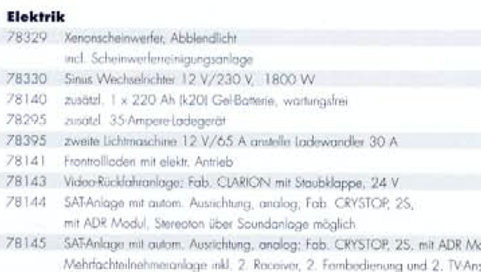

Re your second alternator at 12v,
78395 basically says, "second alternator in place of charging converter" so 65A instead of 30A as standard, if that's how N+B plumbed it in it should be good for that amperage.
