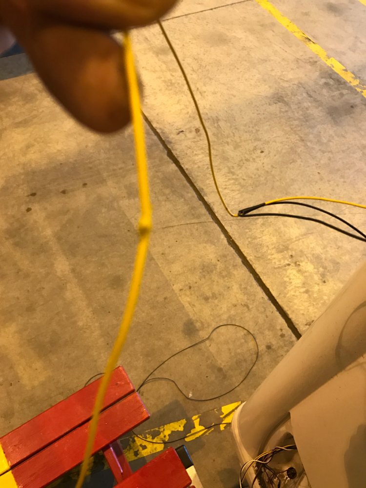

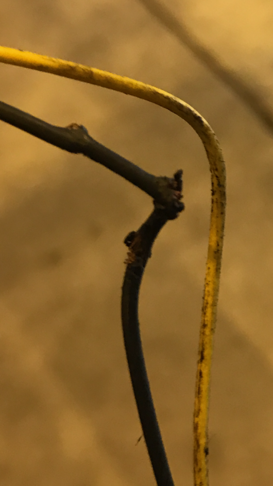

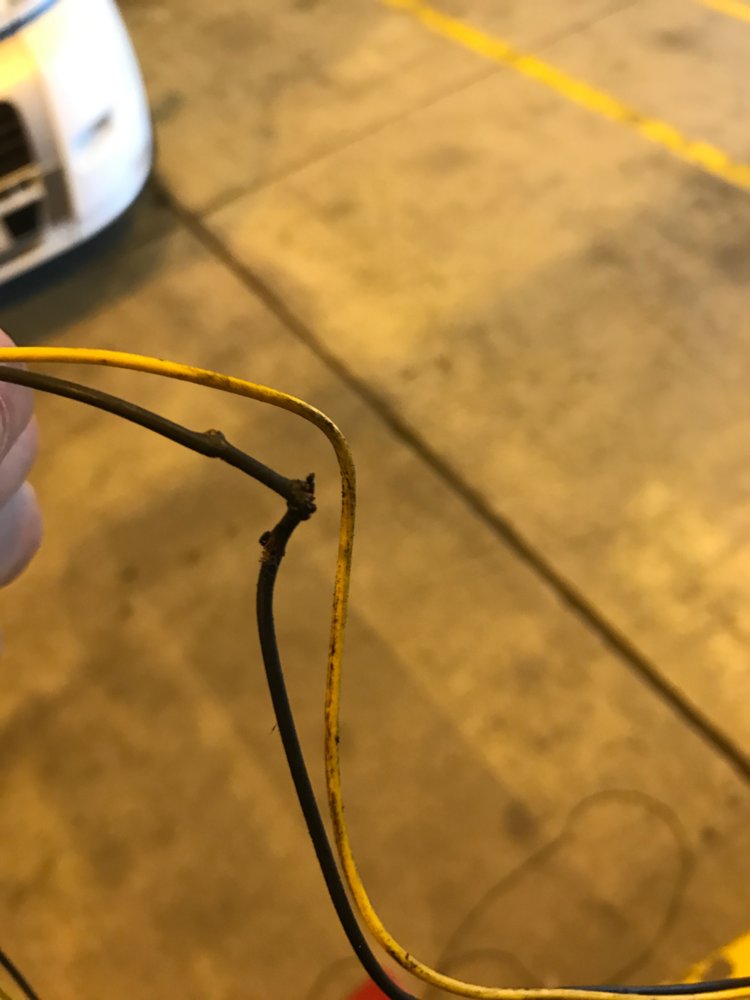

I have the same lights on my AT and had problems with mine, only at the rear. You should have seen the disgusting mess they made when fitted at the factory.
The wiring to the rear lights, literally came across the rear chassis and straight up to the light fitting. No insulation over the wires, no tape to hold them together and free to corrode in all that nature throws at us.
Hope it’s sorted asap for you 👍🏻
Just a few pictures of the rear light wiring and the AT workmanship involved in high end quality motorhomes.
