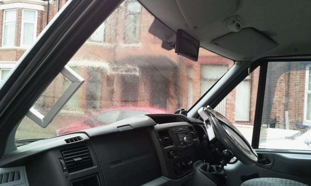

I have done it on the mk7 transit..
As you say a really handy gadget for folk climbing in and out of the cab..
Even though i'd seen commercially available ones on mini buses and presumed there must be fitting points on the pillar...I just fabricated my own out of box section steel and put a flange on each end which allowed bolting to the post.. I just careful cut round the plastic trim and refitted it around my post..
It wasn't as pretty as the ones I'd seen on the mini buses but served its purpose just as well..
If I can find any photos I'll post one.. but sadly I no longer have that vehicle..
Andy
andy63
Jan 19, 2014
4,672
15,017
south shields
29,767
None
since 1990
As I said not very pretty but it was a solid grab handle (y) :ROFLMAO:

That looks lethal if you were thrown onto it in an accident.
It's not as bad as it looks ..
The mot station said it was fine..but the way it looks on the photo I'd agree:ROFLMAO:
The van has a passenger side air bag as well..not that the handle projected into the cab or interfered with said air bag anyway

All the grab handles I've seen on commercial vans (transits anyway )have been fitted to the front or A post.. not the B... its a more natural point to look for some support when getting into a van cab ......on the drivers side its common to reach for the steering wheel for a bit assistance ..nor the rear of the seat.. ..(y)
It would appear not many people have gone down the road of trying to fit a grab handle..judging by most of the replies:unsure:..I can understand that having done it..its far from a straight fwd job as the op acknowledged in one of his early posts..
The difficult bit is the bit you dont see ..ie the fixing to the post...so that firstly it's secure enough to take a fair load without damaging post and wiring loom ..and secondly you can refit the trim to make it look OK..
I always did intend to tidy up the handle I fitted.. once I knew I had got those bits right because as lenny has said with its rectangular profile it looks a bit dangerous.. but it was quicker to construct and try it out that way..and I never got round to finishing it properly..:(
Andy.
