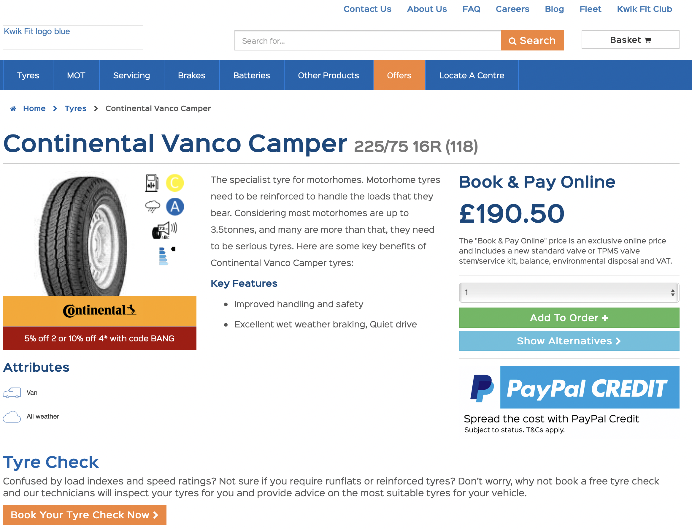

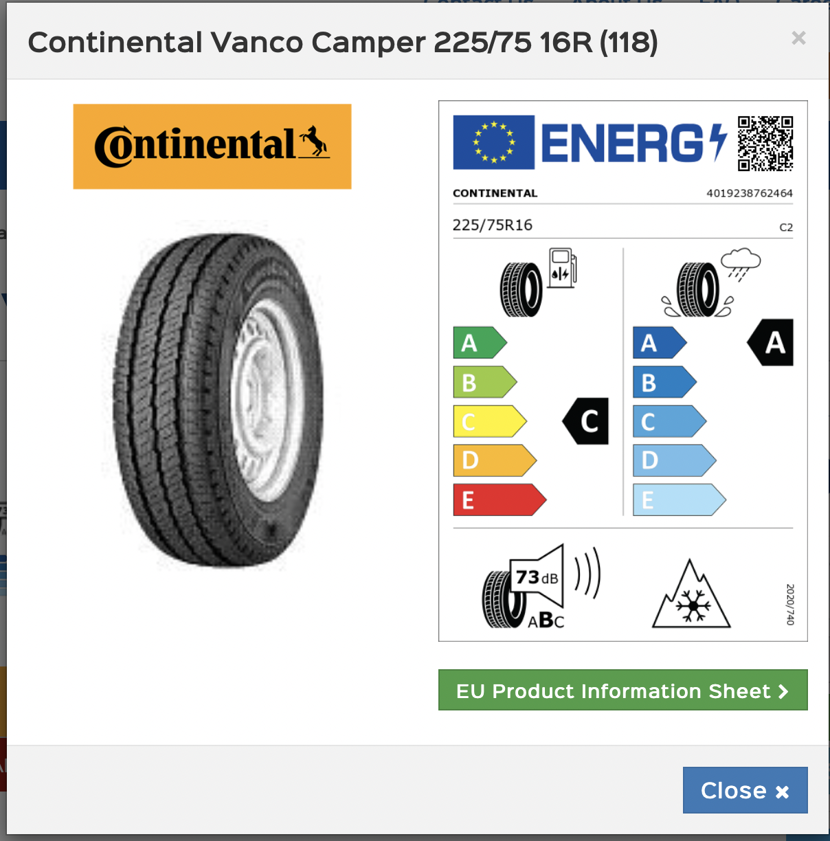

I've been looking for some new tyres for my van, and have found the Contis at Kwik-Fit. The three peak tyres are the 118 load rating, not the cheaper 116/114

I know 😉. I’ll be fitting Michelin Agilis Cross Climate to my van in the next couple of weeks, but thought others looking for an all season camper tyre might like to know that the Contis are an option, and they have the correct 3 peak label rather than M+S.
I fitted these to my van earlier this year, very happy with them as are a few others on here.
