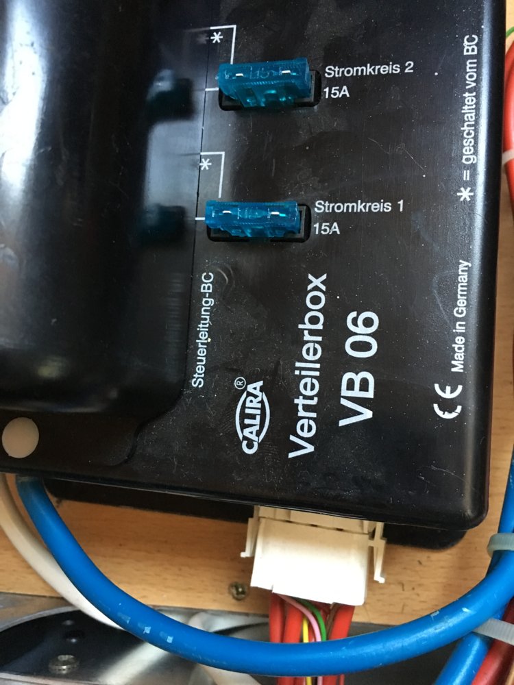

    I doubt it is Trumatic, they focus on heating controls. There should be a 12 volt distribution box somewhere with a name or model on it.

    Can you see where that ribbon cable goes on the left?
  15. Techno
    Techno Funster Life Member
    Joined:
    Jul 28, 2010
    Messages:
    14,482
    Location:
    Leeds the one up North
    Ratings:
    +19,322
    The fuse box has four of the circuits starred ** and indicated that they are switch from BC presumably that is the overdoor panel. What does it say on the other fuses? it is blurred

    The ribbon cable goes to the control panel. Nothing looks out of order there.

    I've changed all those dudes for new ones.
