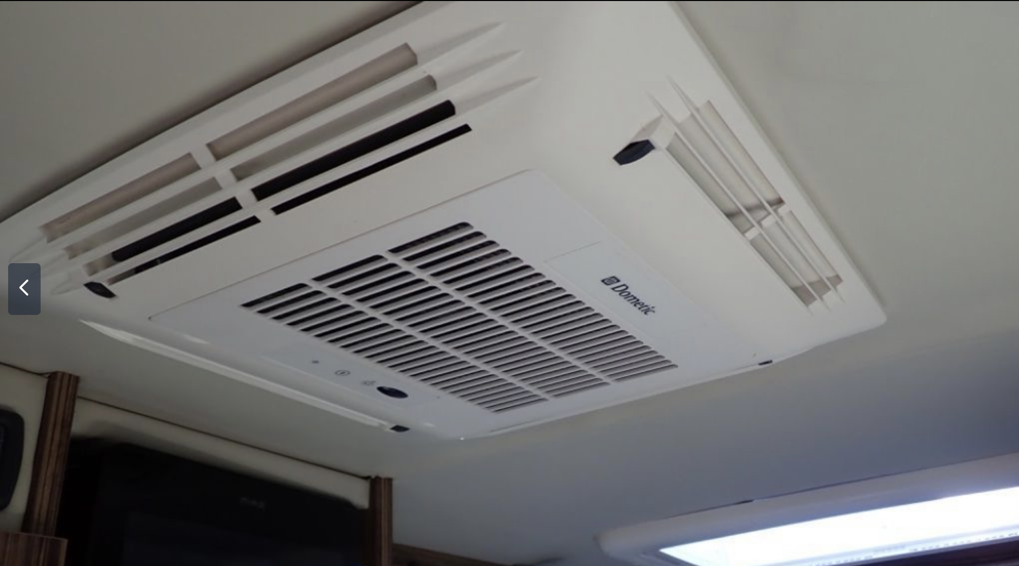

I’ll probably take the air con of my new van to put more solar up there, what would be the best way to fill the void, I think the hole is 300 by 300mm.
Has anyone filled a hole…😉😎

I would expect the top of the hole will be quite easy to make good, the inside is a different story IMHO.
Yeah, I’m thinking of an alloy plate sikaflexed Down, painted and inside some cellotex or I’ll know what they’ve use for insulation when I take it out and replicate. But without replacing the whole roof covering which is a type of vynal putting something on the ceiling to disguise it…🤔

I expect it will be 400x400 I would be inclined to fit a standard roof light it will sill give you a lot more roof space than having the aircon up there. I reckon you could still get a 150/175 watt panel down the side of a standard roof light.

Lenny is right all Dometic apertures are 40cm x 40cm You have a ridged roof so the "flat" area will have been fabricated and raised to further complicate your plan!

Imagine a ridged roof, __--___--___-- The air con (or any other thing that needs a flat surface for the seal to work Max Fan for example) seal would only touch the "ridged" bits and water would piss in. So Dometic produced the adapter plate which is "bonded" to the roof, some times body filled and colour co-ordinated to provide a 40 x 40cm hole with a about 150mm flat surround for the neoprene seal to "squash" down on making it water tight.

I removed air con unit in one of my builds.Simply cut a pice of 2mm Ali plate four in’s bigger than the hole and stuck it in place with Puraflex 40 and used some 45 mm x 5 mm plastic to make up the ridges in the roof. Just like I would if fitting a roof light. Inside we were insulating and reboarding anyway. I have also in the past made a Patrice out of 12 mm furniture ply, edging it and put a couple of movable spot lights mounted onto the board that basically made a feature of covering a hole in the roof 👍Following he rule of if you cannot make it look right make it a feature😊
