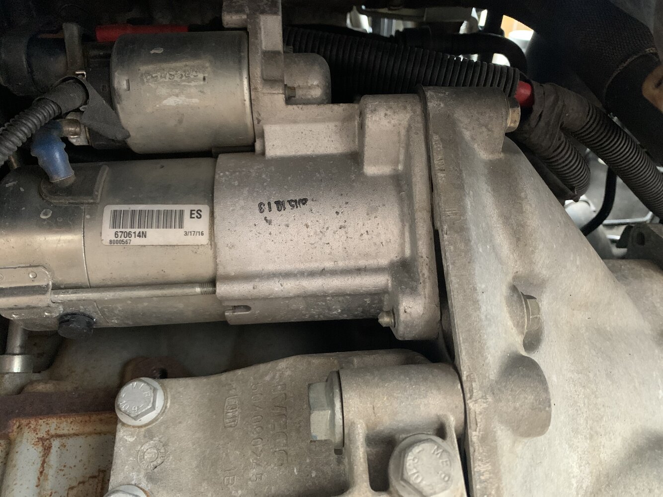

Alright, stupid question...where is the starter at?

solenoid stuck ? Hit starter with a hammer or bar on the casing
First line of attack as a breakdown driver.
Give it a whack, if it doesn't work there's a good chance its not the starter pinion jammed.
Always the easiest thing first.
Our wreckers had a long metal bar just for that purpose.
