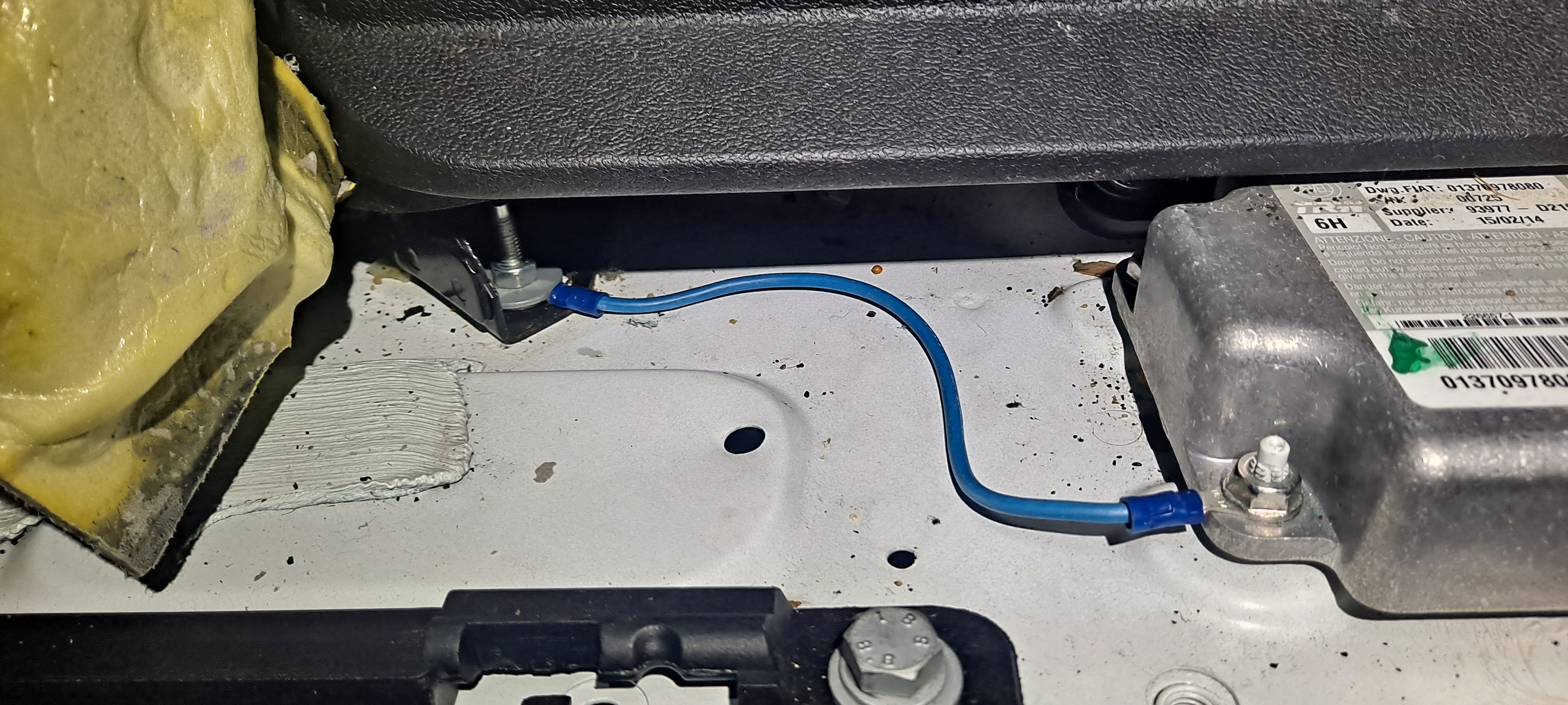

Yes same one as far as I know. I'm going to fit an extra earth strap as mentioned earlier when I get round to it.
Just been out for a look.
Bit better than the fiat photo. Pull the floor foam stuff up and link the 2 blue circled bolts. 👌

Got my airbag ECU body earthed direct to the battery neg post too. Since this photo have added a 15 amp in line fuse to make it idiot proof (in the event anyone tried to start the engine with the battery negative disconnected). I noticed the lower left hand ECU bolt on Richard n Anne's is painted - and mine isn't.
I don't think that lower left hand bolt is painted @drex.I believe it is a white plastic bolt for some reason.
