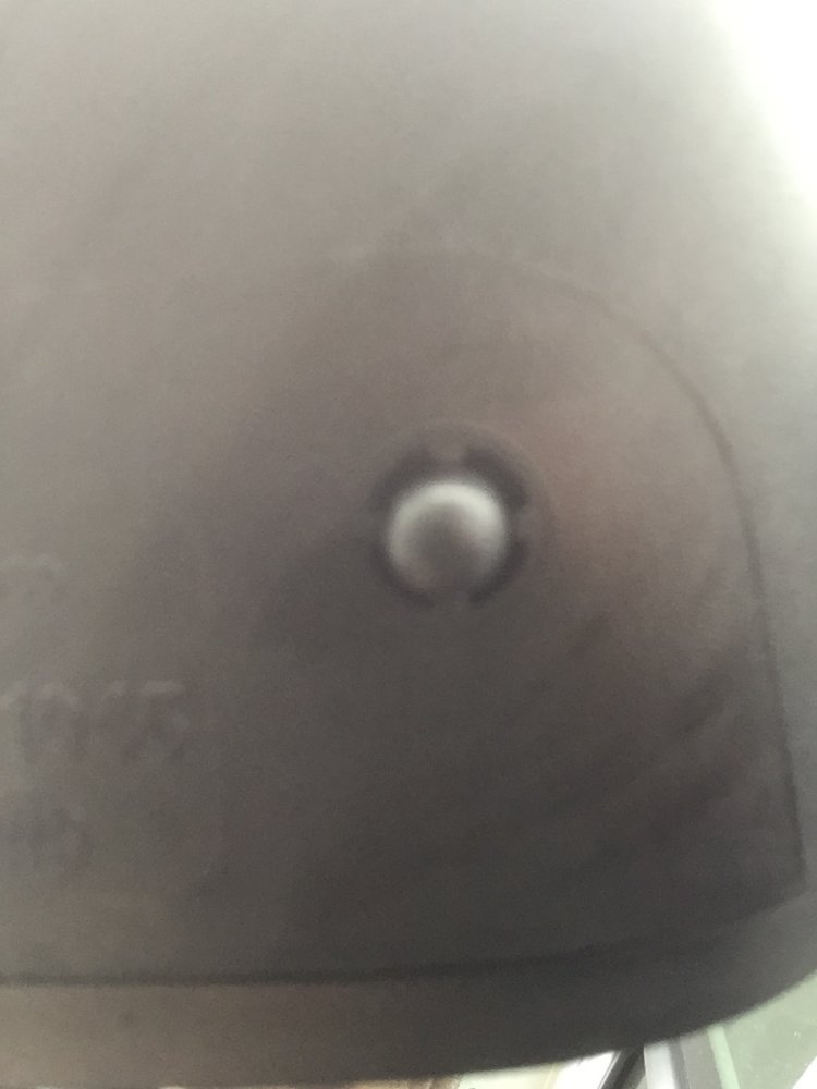

If you do have the wing mirror type. It looks like this on the underside of the drivers / RHS mirror
