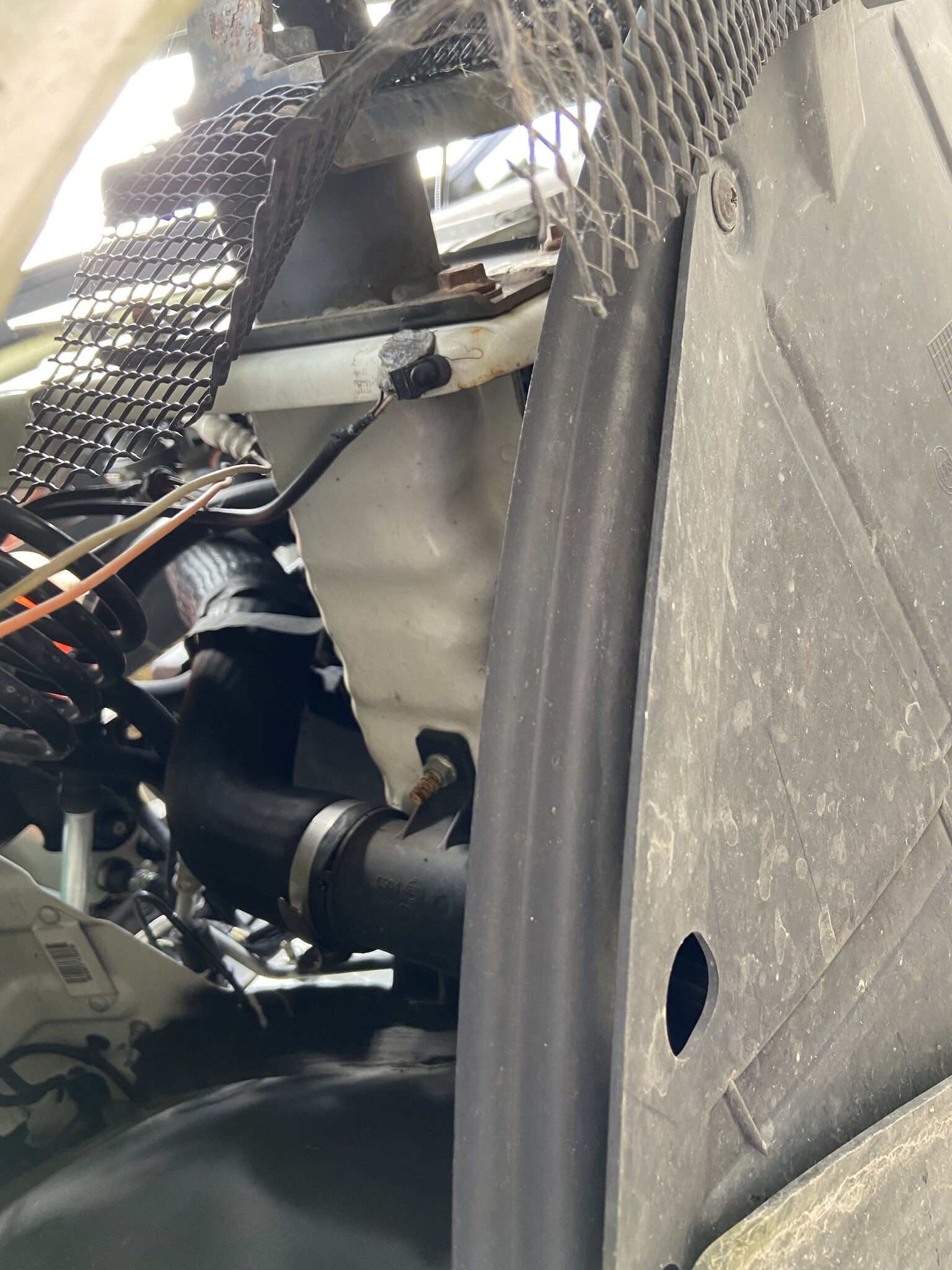

This has been playing up on mine for 6 months, I haven’t changed it simply because I couldn’t find it. Looked bloody everywhere!
Told me there was ice on the road today. :-(
It isn’t in the mirrors like normal, the plus side is I now know exactly how to take the mirror to bits. I also know where most of the earth terminals ground all over the chassis.
If you were wondering where yours was on the same model, it’s near the front, forward of the drivers wheel arch stuck with some sikaflex to one of the cross members. Look up from the front right hand side near the radiator and it’s sitting there.
I have ordered a Peugeot one that I could get tomorrow as they look identical and I have to cut the cable anyway, for £8 it was worth the punt as I suspect they are identical thermisters inside.
It looks just like the one in the mirrors just stuck to the cross member.

I’ve traced the wiring up, around, behind and along. Eventually it disappears down the side of the windscreen washer reservoir toward the dash area but I can’t see/reach any further without removing the headlight and the dashboard end cover inside.
I found mine today after months looking for it off and on, I’m sure I’d already looked up there too.
