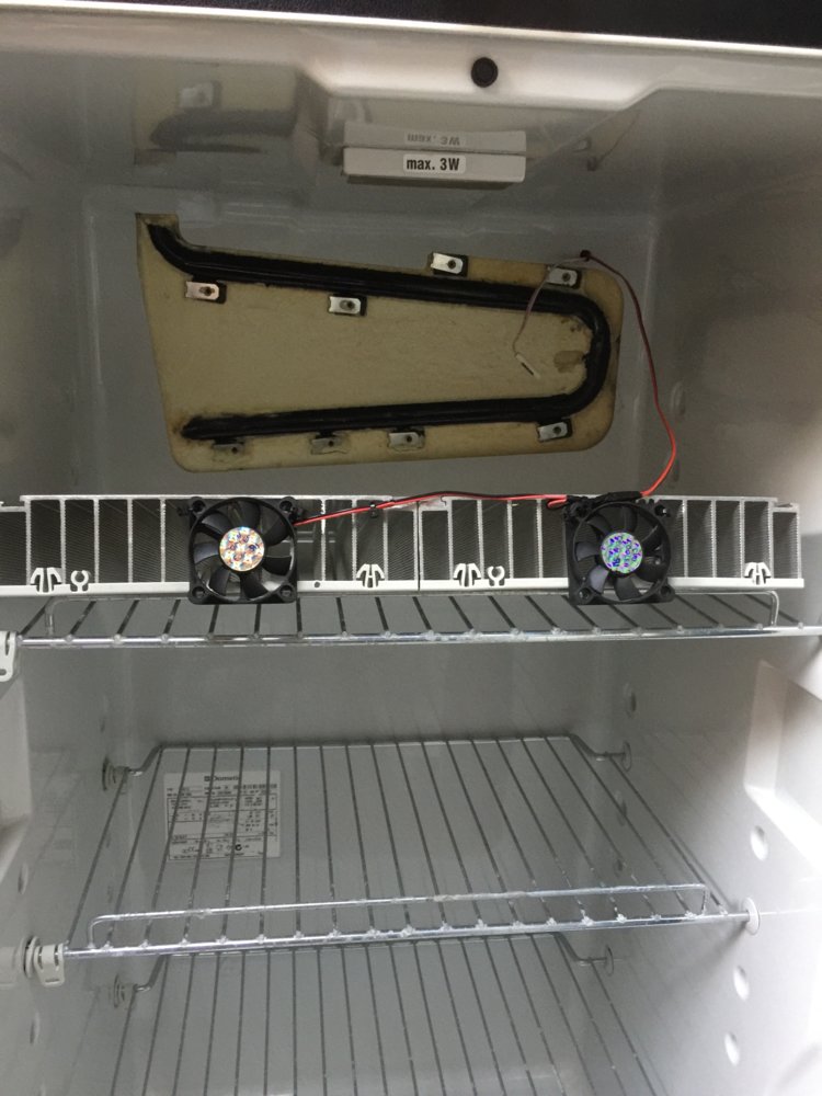

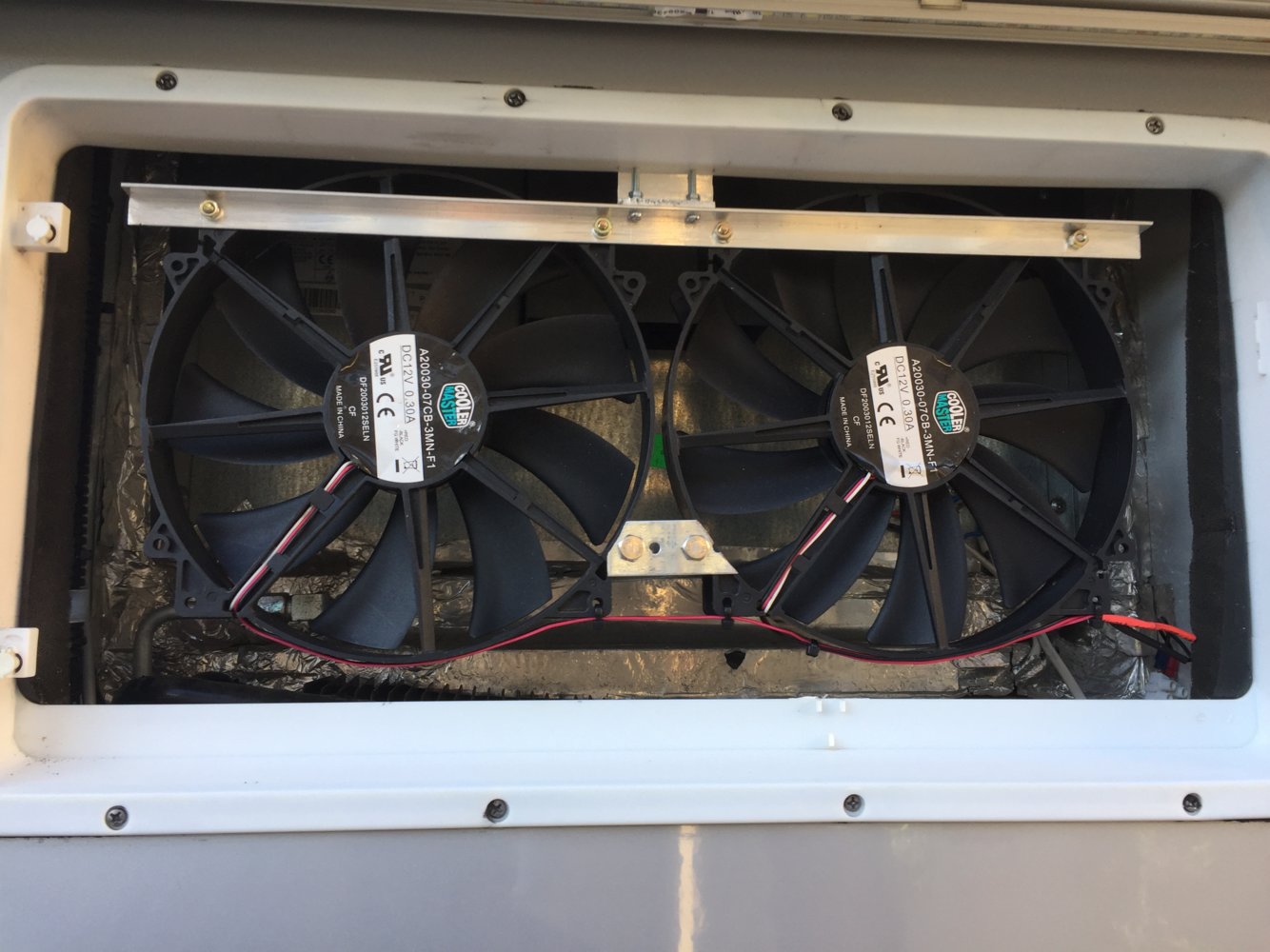

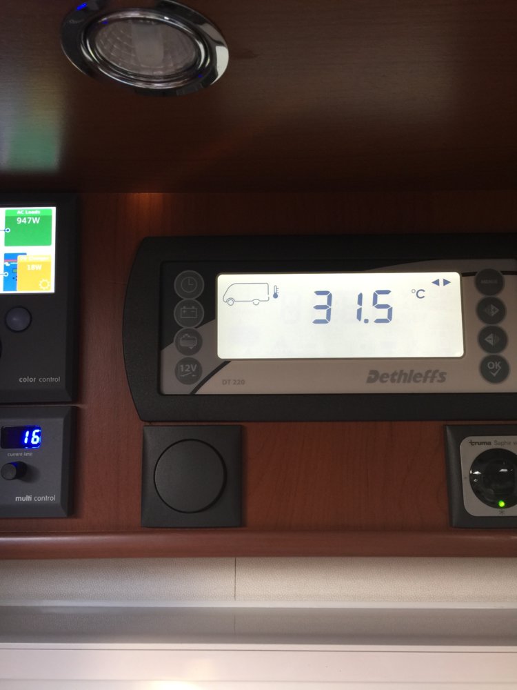

I think the main problem is ‘volume’ which is apparent in a lot of motorhome issues. My fridge is 11 years old and I believe back then (2008) the people constructing motorhomes and all the internal fixtures and fittings were built to a better standard IMO. Take for example currently I’m in Croatia and the external temperature is 31.5 but my fridge is at 3.7 and freezer -16.1. I have 2 big fans on the top vent and also fitted 2 miniature fans on the internal fins. I have also renewed the heat thermal paste on the internal pipework. A lot had to do with maintenance too but if yours is under warranty then I assume it’s fairly new.
The heat thermal paste does dry out over time and I think renewing that has made a massive difference.

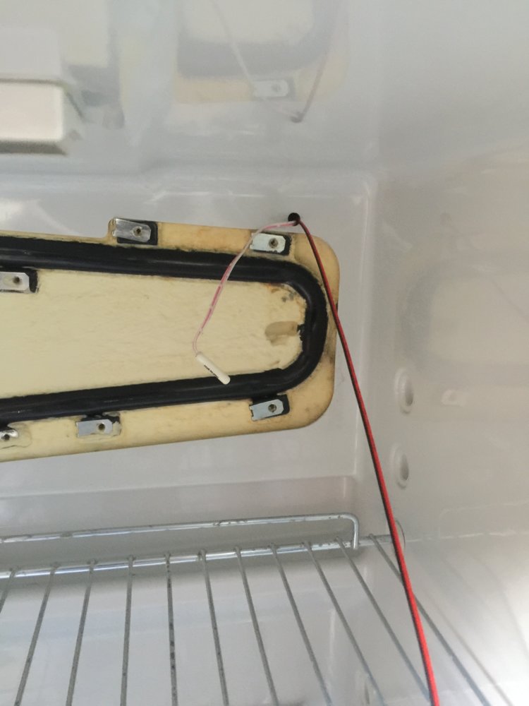

Did mine, you simply unscrew the aluminium fins, remove the old paste and put plenty of new on. You can buy it on ebay as heat transfer paste for computer processors. There's a thread about it somewhere...

What is really annoying is that most of us fit additional fans and get them working reasonably well, so they can be improved but Dometic do nothing about it.
As well as fitting 2 external fans in the top grill I fitted an internal fan.

Where about in Croatia are you? I’ve attached some pictures of the process but as Richard and Ann has said just remove the cooling fins at the back of the inside of your fridge and remove the dry old paste and apply new paste. Remember the fridges work by removing heat from inside the fridge hence renewing the heat transfer paste works wonders ?
You can also see my 2 miniature fans I installed on the internal fins which distributes the cold air around the fridge.
