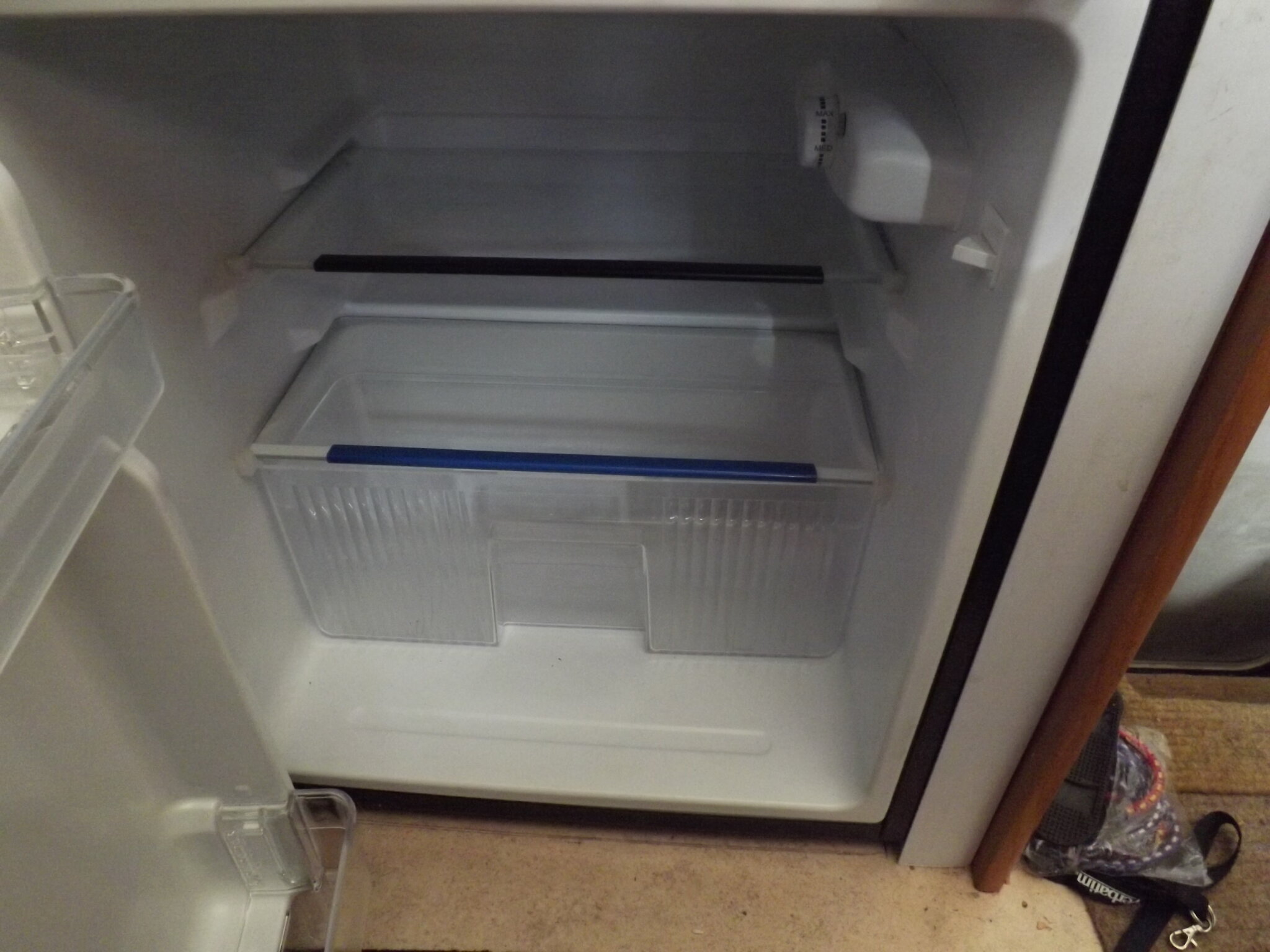

I bought a Vitrifrgio 115l last year. It made ice in no time at all and was very quiet. It didn't cost 2k either...
The Vitrifrgio 115l would leave a rather large hole above it to fill where our tall 190 litre Dometic was. :giggle:

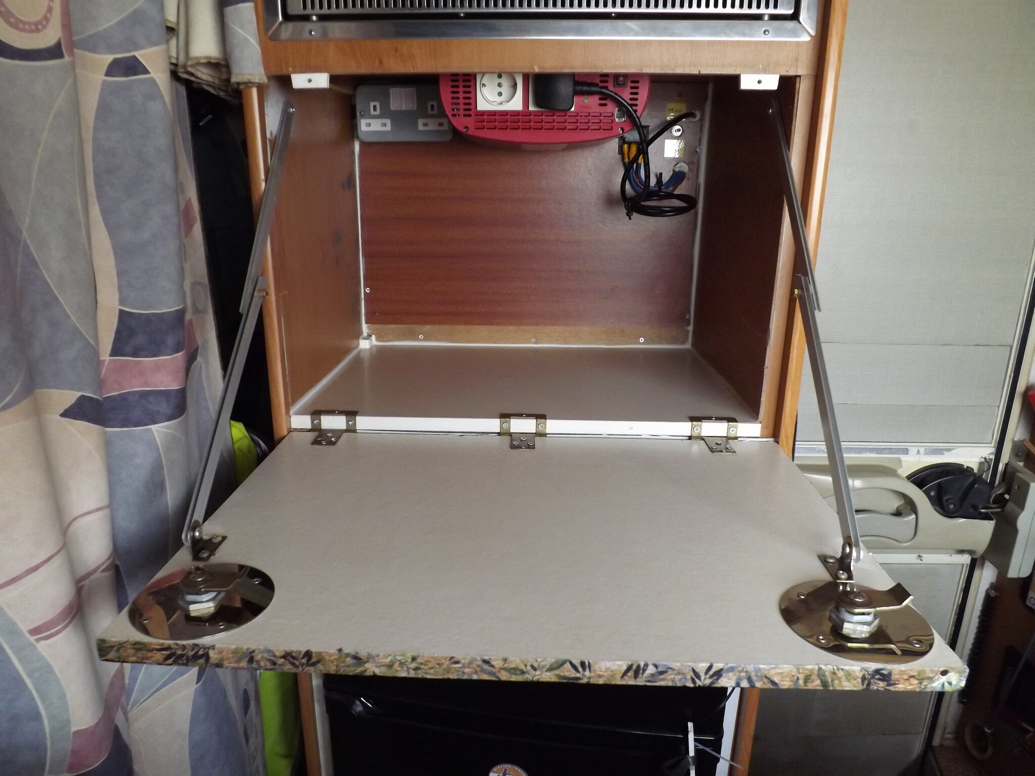

I used the spare space to make a cupboard big enough for two full face helmets, associated m/cycle clobber and the 1000 watt Sterling inverter, made up some strong stays so as to be able to use the lowered door as overflow worktop, made up a fridge door lock that is held closed with a couple of tapered wooden pins, a piece of old inner tube to secure the door open when not turned on. In the fridge, things were moving around, so I fitted some strips of plastic from folders of paper, the freezer has a cheap plastic basket to keep things tidy. The fridge/freezer is smaller but the extra depth means I can carry frozen pizza's more easily and is lighter in weight. The arty one in the crew decorated the door, acrylic string art?
Did you connect it yourself? There are a plethora of proposals across the internet regarding installation. I'm moderately fettling competent and am prepared to install one myself if I have clear and suitable guidance. Alternatively I'll call for the services of an engineer. If possible I would prefer both 12v and EHU services.
I've just noticed this post and my apologies for not answering it. I connected it myself in just a few minutes as the wiring was simple and clearly documented. I spent £60 odd on the 12/240V auto changeover converter and it ran happily on either .
