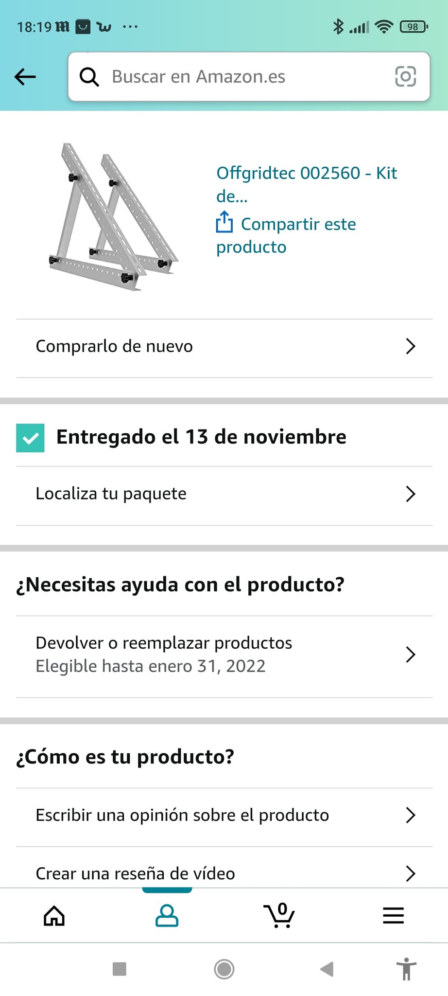

Can you show a photo of your tilting panels please ,for info. (y)
Sure, but as my left hand is currently restricted in movement I can send you the lowered position only...also the diagram from Amazon..
Thanks, relatively simple then. I saw one on a van that had a motor and operated by remote control,but it spanned over his whole roof and covered his top vents untill it was raised.
Basically some nuts and bolts and 6 short lengths of dexion. I would be concerned that the knurled plastic encapsulated nuts would degrade and fail driving down the road
Then it's my duty to ensure that these are well maintained and renewed periodically, in the meantime may I suggest you don't drive too close to a Silver Hymer on the roads of Spain..
