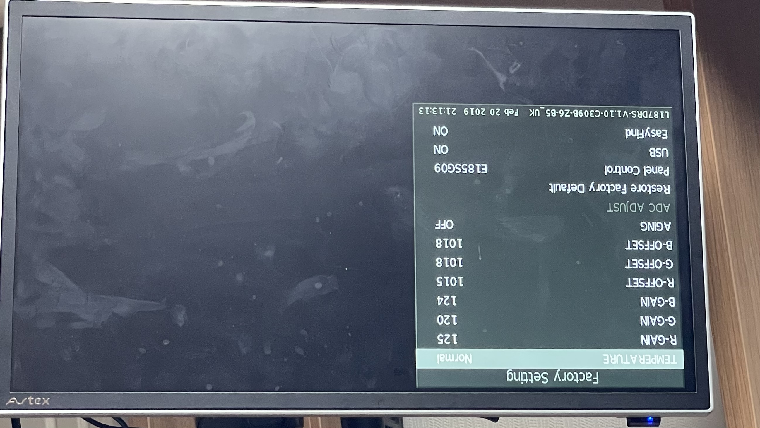

Hi all.
I have a acted L187-DRS series 7 TV.
The picture display has flipped upside down for some reason. I can't find any options to turn it back the right way...
On the later models there is a mirror image option in the settings but on mine there's nothing.
I have also had a look on the hidden 2580 menu from Source and tried a reset from there and its still downside up
Any ideas anyone - other than turning the TV itself the wrong way round as I can't do that!

No scaler output anywhere. 7343 doesn’t do anything only 2580 but nothing there eirher

my setup page is older than that.
I will need to ring them tomorrow, it was fine last time we used it so not sure why it’s switched round - definitely no settings anywhere to fix if
That corresponds with my search. If it is the one intended for an Autotrail it can't be altered.

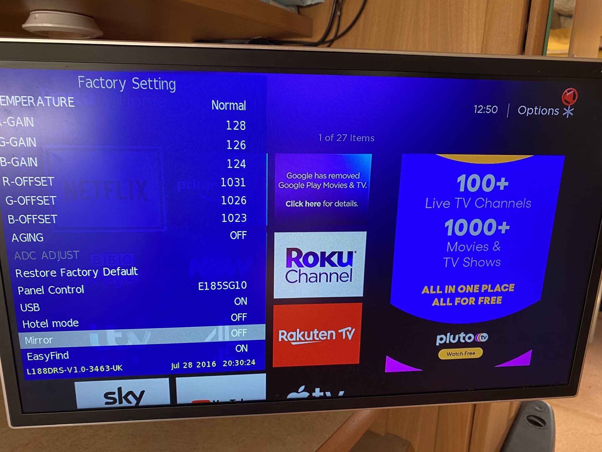

I’ve got one removed from an Autotrail and had no issues changing the screen within the settings menu . I will try and look at the settings when I am back in the van later 👍🏻

It does appear the series 7 TVs have a difference in the hidden menu to the Series 8 .
