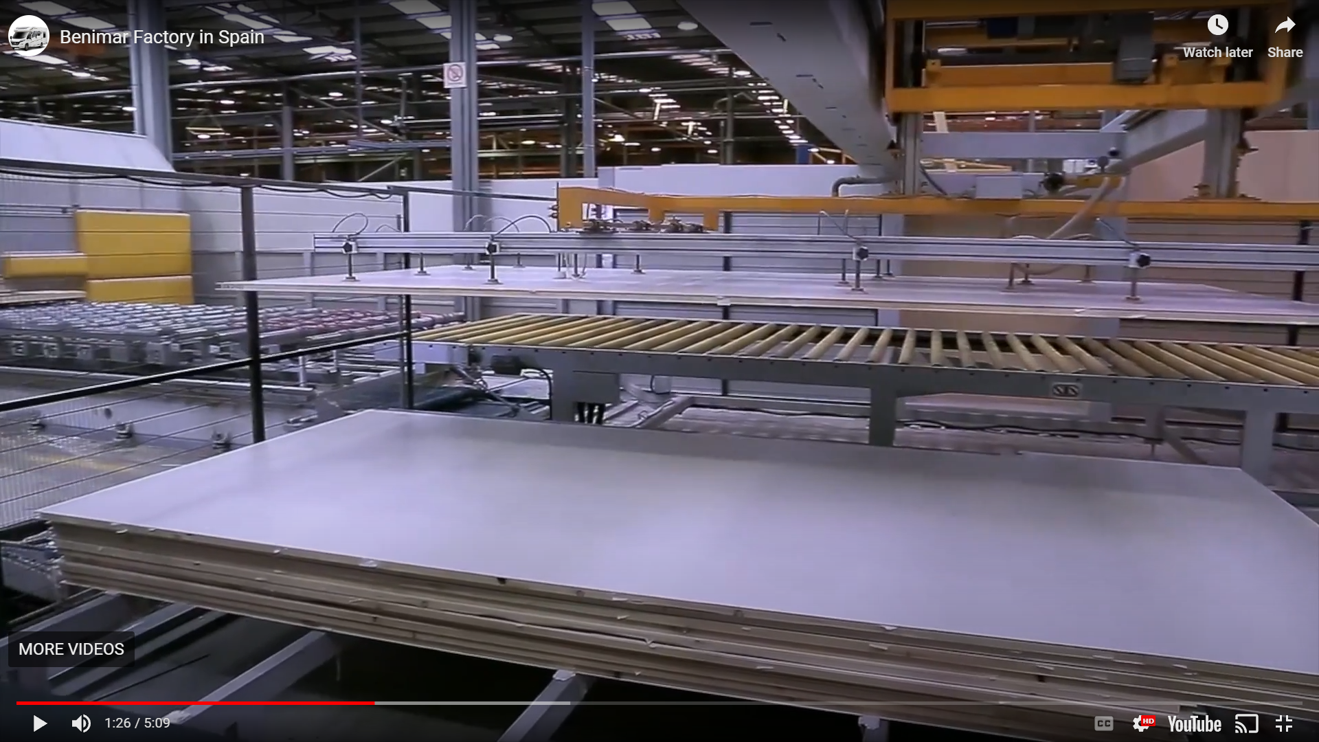

Out of all of the Trigano group homologation designs, Benimar stand alone. Each panel frame has a wood edging strip. Adria, Auto Sleepers, Auto Trail, Chausson, Roller Team, Mclouis, Mobilvetta & Rimor don't.
All of the Auto Trail F line's have a max towing limit of 1000kg. The Roller Team Zefiro range, 1500kg and their newly updated Auto Roller range now built exclusively on the Ford has a towing limit of 2000kg.
Can't see any wood edging here:

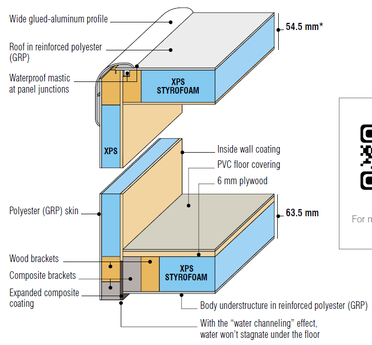

Don't know where you have dredged this info up from, but it appears to be naff. Below is a drawing from the Chausson catalogue which appears to be exactly the same as the Benimar construction, and does include a small amount of wood.
Whatever... I'm not arguing over something I know to be fact.
That's wood.
Just for the record I worked on horizontal & vertical integration For the Trigano Group across all of their brands. Chausson/ Challenger are not the same. Roller Team/Mobilvetta which share the same Tuscan production facility are slightly different again, they've replaced the outer wood brackets with XPS. Benimar don't have the base platform layer of composite, it's deeper XPS, wood and a 3mm GRP overlay.
