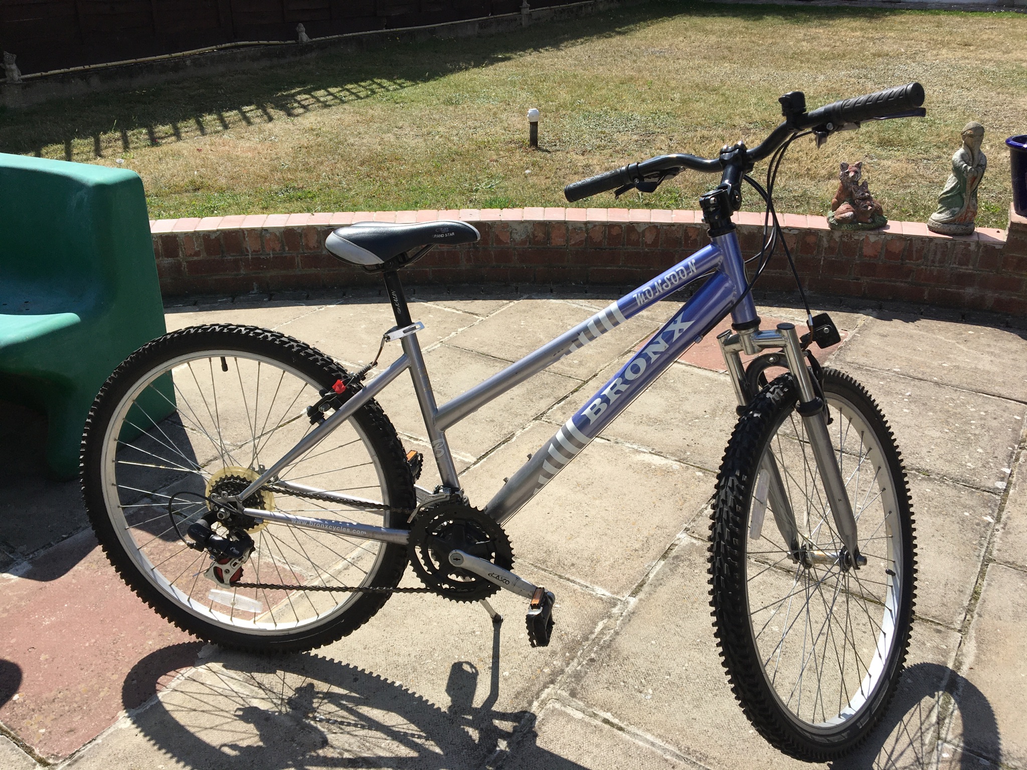

I recently bought a bike off another Funster (redsonya) with a 250watt front wheel kit and it's really very good. As mentioned get a decent sized battery to give you a reasonable range.

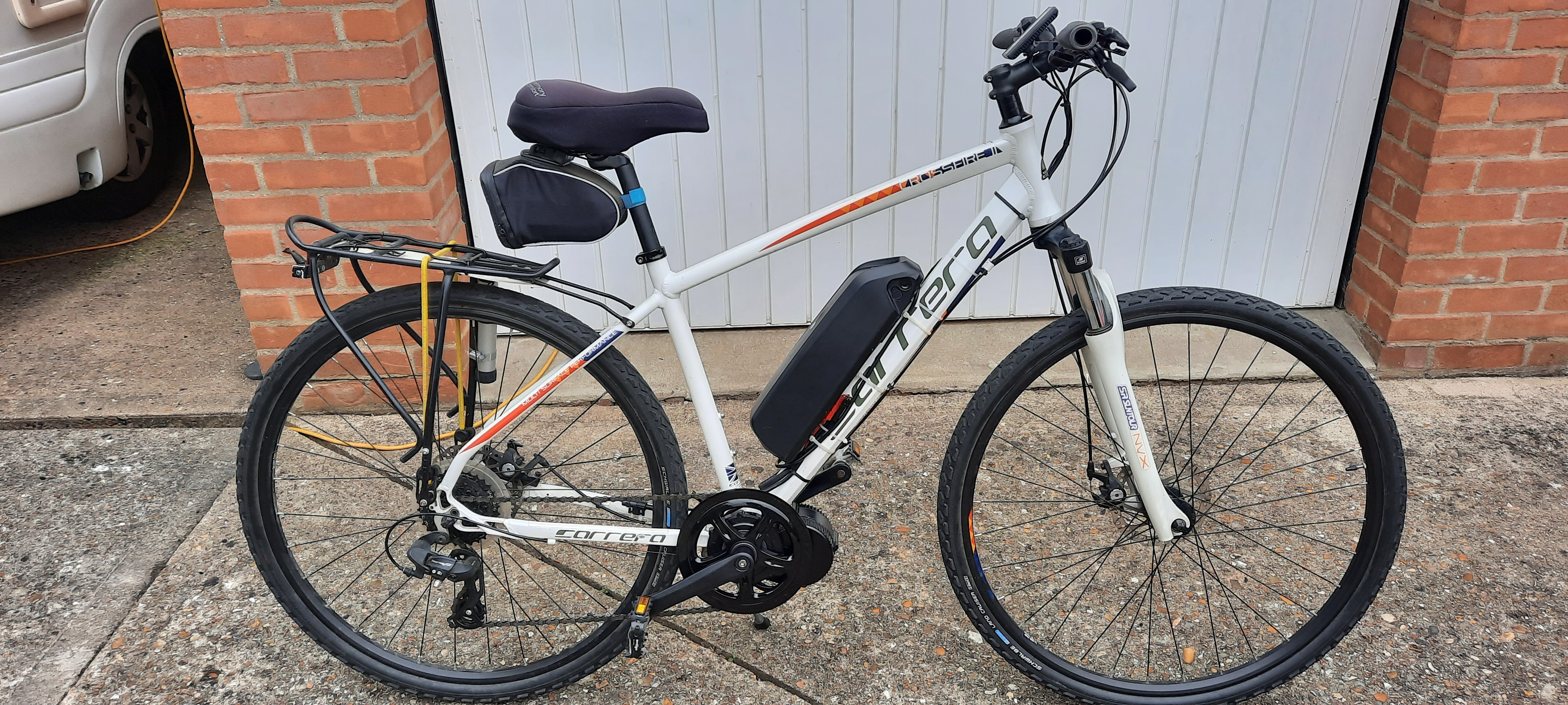

Having ridden my converted bike reasonably regularly now I can strongly recommend the TongSheng unit that i mounted on the pedal axle. Batteries last for at least 20 up and downhill miles and gear changing with my 8 derailleur set is seamless. The bike feels like the pedals have a turbo fitted and when you get a little fatigued the throttle thumb switch is fantastic for additional assistance. We were in Cornwall recently and cycled from St Austell to Mevagissy, we have two lazy dogs so they spent most of their time in the wheeled dog trailer attached to the back of my bike, I cycled up a gravelled track around a mile long and at a gradient of around 1:20 with the dogs on board, I made it to the top without getting out of the saddle! The trailer weighs around 25KG and the combined weight of the dogs is 45KG. Totalling an extra 70KG! The ride back to St A included around a 1/3 mile up a 1:4, still with trailer but no dogs, that was quite hard work but I don’t think I could have even pushed the bike to the top pre-motor.
I have also fitted a fat saddle as the sharpened razor blade that came with the bike meant I never cycled more than 5 miles without being in extreme discomfort. Check out YouTube videos on saddle size and “sit bones” (how to measure how HUGE your ass is!) before you buy that comfort enhancing saddle.
So all in all I’m very pleased with the conversion, you do need some mechanical nouse and a couple of specialist tools for removing the pedal cranks, but I have transformed our bikes for around £550 each.
Just a quick postscript, I’ve ridden a Bofang equipped bike recently and the assistance doesn’t kick in until the pedals have rotated around 1-1.5 lots of 360* when setting off, which I found unsettling, the TongSheng units give instant assistance, and they’re cheaper.
