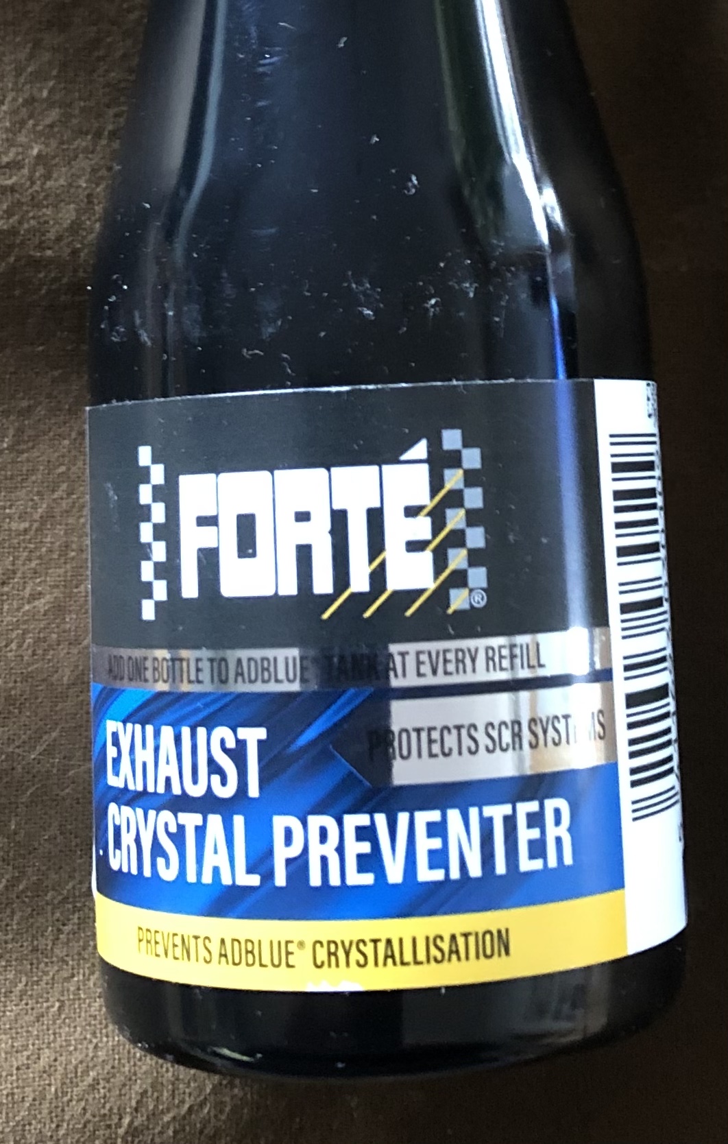

Whilst on the subject of Adblue were you owners that use it aware that the system can ‘crystallise ‘ internally causing massive potential problems with the system. A commercial product is available to stop the crystals forming. (See pic) . I buy this from my local garage adding one bottle every 2 Thousand miles or so.

Whilst on the subject of Adblue were you owners that use it aware that the system can ‘crystallise ‘ internally causing massive potential problems with the system. A commercial product is available to stop the crystals forming. (See pic) . I buy this from my local garage adding one bottle every 2 Thousand miles or so.View attachment 674877
