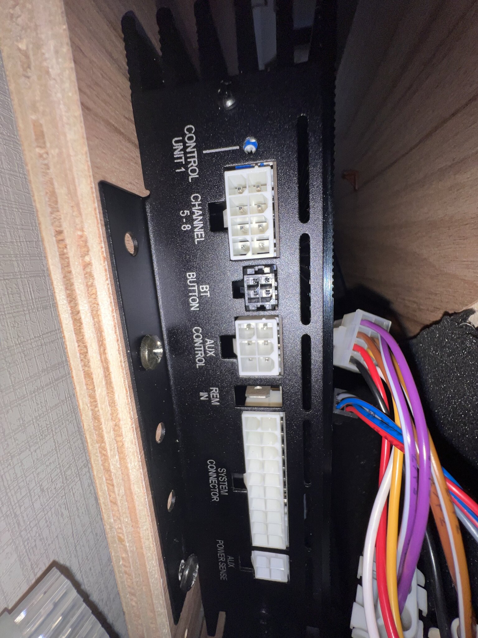

Does your Hymer have the audio system that plays your TV sound through the cab speakers ? If so the DSP controller box might need a reset. I seem to to remember this happening on my 2018 Hymer Exsis-I 588.
The DSP is located under the rhd side storage box, under the window, next to the drivers seat. There was a panel in the bottom of the storage box that allowed access to the DSP.
Then there is a reset button to press on the DSP unit.
If you search back through my posts to 2020 - 2021 I may have written up the procedure.

I will have a picture of it on my desktop pc but I’m not at home for a few weeks.
I seem to remember that the acess panel in the below window storage box base comes out with a couple of screw and then the dsp is visible.

DoroDormobile Yes it’s visible but a right bugger to get at or see the buttons and connections I ended up removing the side panel to get a look at the DSP.😊👍

I have managed to get the base out of the storage box and have a look at the DSP. The status light is flashing red which doesn't look like a good sign. I tried pushing something into the control button next to it but wasn't sure if it was a button or a light. it hasn't made any difference. I did manage to get the photos attached. Ideally need to find the manual.
There probably isn't much point in looking to replace the head unit until I work out whether the DSP is the problem or not.

I removed all the wires from the Caratec unit and found another 'control point'. Pushing on this also had no effect on the status light. All power was removed when wires removed and this also appeared to have no effect.
Still do not know if problem in Caratec DSP or if it's in the Zenec head unit. Ideas on what to do next welcome

One step forward. I emailed info@caratec.de and they sent me a small programme to put on a microSD card which I inserted in the microSD card slot in the caratec DSP (see photo above) while it was operating. This installed an update and the DSP is now apparently running again as the LED has stopped blinking red and is now steady green.

No. Still no sound. Have now downloaded the latest firmware update from Zenec website - 3.4.1 - installed it and still no sound from Tuner, TV or bluetooth to mobile phone. Currently out of ideas.

Try taking the cables out from the Caratec unit and connect them directly to the loom on the other side that’s what I did and got my sound back never put the Caratec back in as it never worked properly.😊
