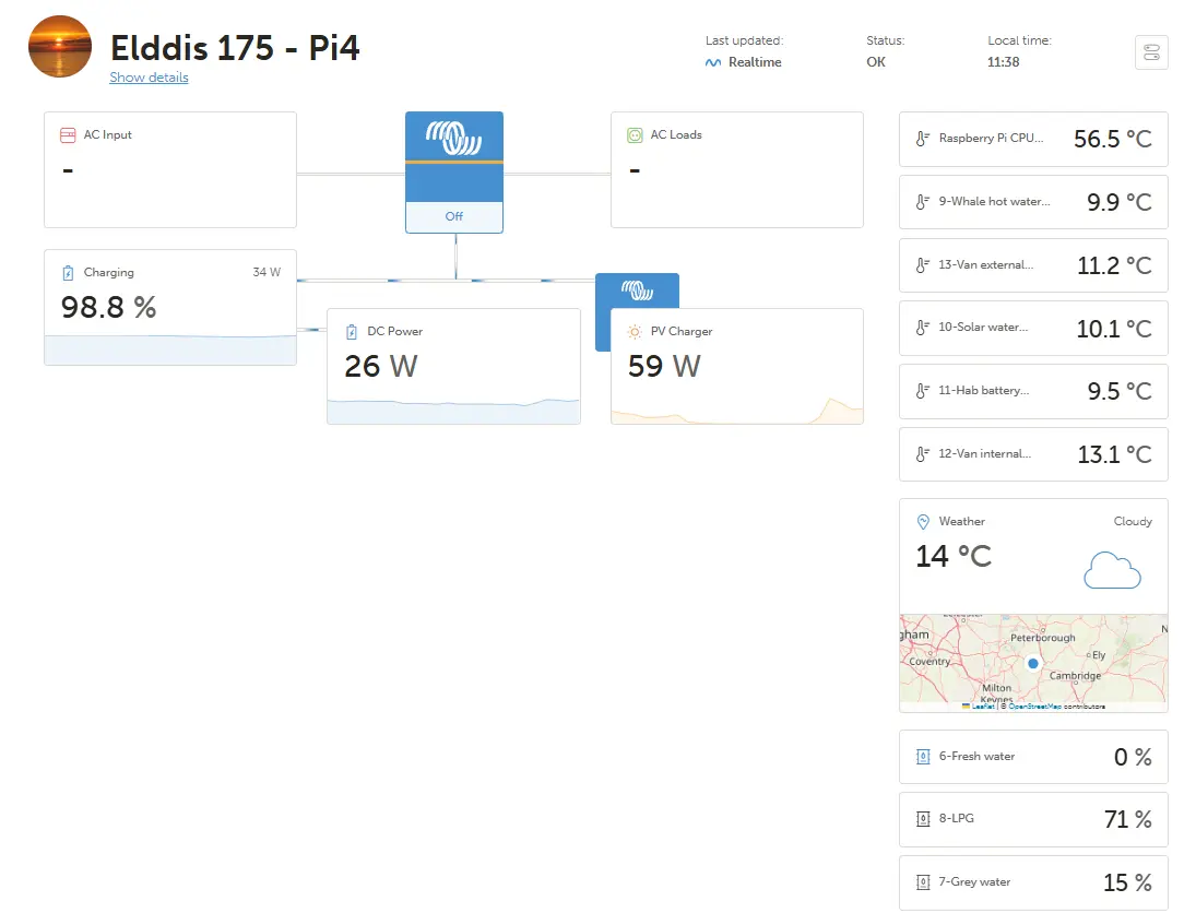

Victron Smart Shunt, connected to a Raspberry Pi running Victron’s Venus software. It’s not too difficult and fairly cheap, certainly cheaper than a Cerbo GX. I would suggest buying the Victron USB cable to connect to the shunt.
I was a complete novice with Raspberry Pi, bought a Pi 4 and case from eBay, then followed the video tutorials below. Image of my dashboard
Plus with the RasPi you can monitor your water and LPG levels, plus various temperature on your van as well as your van's location on a map. (y)

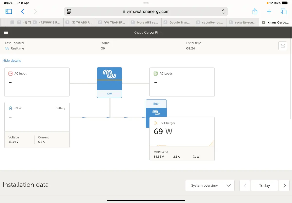

Our system uses the vans Netgear M3 MiFi connected to our Cerbo GX via the vans wifi network. (Cerbo S or Rpi are cheaper options with the same functionality once set up). The Cerbo transmits its information to Victrons VRM monitoring site, so then you can view whatever data your Victron kit has collected either through the Connect App, or through a browser. A Victron smartshunt can give you the leisure battery details such as State Of Charge, Voltage, current in out and/or the temperature of the battery, or the starter battery voltage. The Smartshunt can be supplied with a monitoring gauge if you want that facility, but I just use my phone! You can set up alarms for stuff like low voltage etc, but I haven't bothered with that.
If you have other Victron or compatible kit then that can also be monitored.
You can even build your own dashboard to monitor and control just the bits you want - if you really want to.....
There are other ways of doing it I guess, but this was simple enough for me and accurate.
