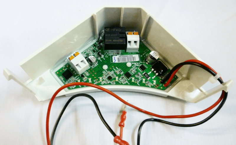

It looks like they are encapsulating the circuit boards now, probably to try and stop the mosture getting in which was causing them to fail.
Here is what the earlier control unit looked like.
O'Leary Motorhomes sells replacements.
Thanks guys - looks like the 'control board' that needs to be replaced is part of the switch itself. I guess that's worth a try before going for a full replacement.

Well, the replacement switch/control board has arrived (not cheap!) and - it the Omnivent works again!
