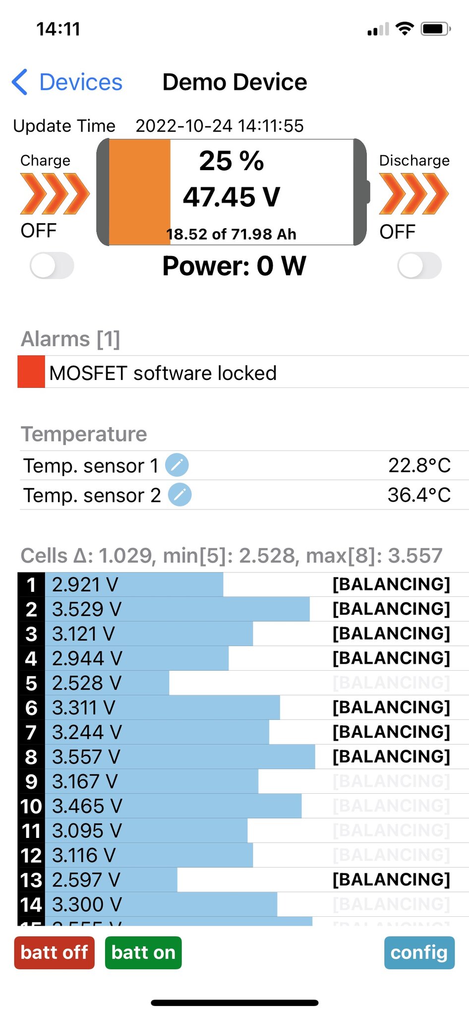

Not sure that all are much of a muchness. The JBD Overkill BMS allows adjustment of pretty much all of the settings. See the screen shots below:
