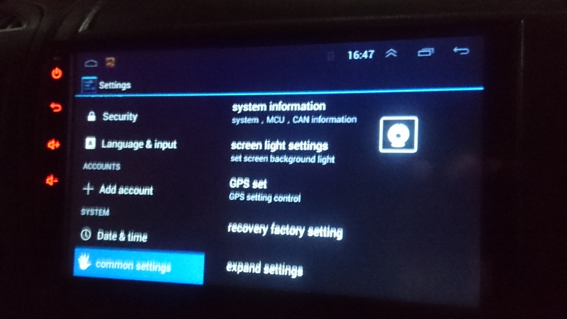

Ours did the either radio/music OR rearview camera thing as it came from the dealer, but I've been playing with it today and deep within the settings there is an option to "Mute" or "Not Mute" - once I had tapped on it to "Not Muted" then the music or radio stays on with the camera active. A couple of pics of the relevant settings screens:

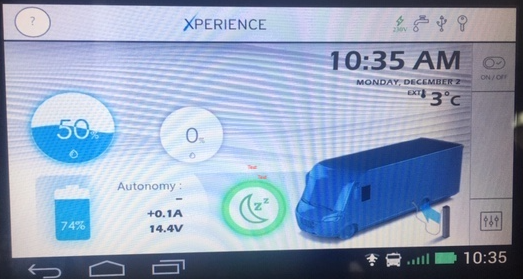

Here is our indication after 2 days of mains hook up (and rebooting the system twice):
I would have thought that:
  1. the battery would be showing 100% by now, or
  2. would be showing as charging given that it is at 74%, and
  3. would be showing a higher current draw from the mains
  4. the app would show that the solar panel is active given that the sun is shining today
If the app happens to be the problem, then, as much as I accept that it may be rather fickle for us to rely on technology, we did pay £800 for this thing and at that price I would expect it to work. Back to the dealer it is then!!

Hi,
I have used this system for 8 months and it works ok, not ground breaking. A couple of responses below for your queries.
1, check the settings to see which amp battery is selected, if a higher amp is ticked it would assume it’s partly charged.
2, as above, battery can not receive anymore if it’s at capacity
3, what is running at the moment? Try turning some stuff on/off and watch what changes the draw has.
4, only shows using solar when no hookup is connected. Disconnect and see what happens.

Thanks Darren.
Dealer advised me to pull the Battery Sensor fuse and refit which appeared to do the trick.
Just hope we do not have to repeat this too often!
