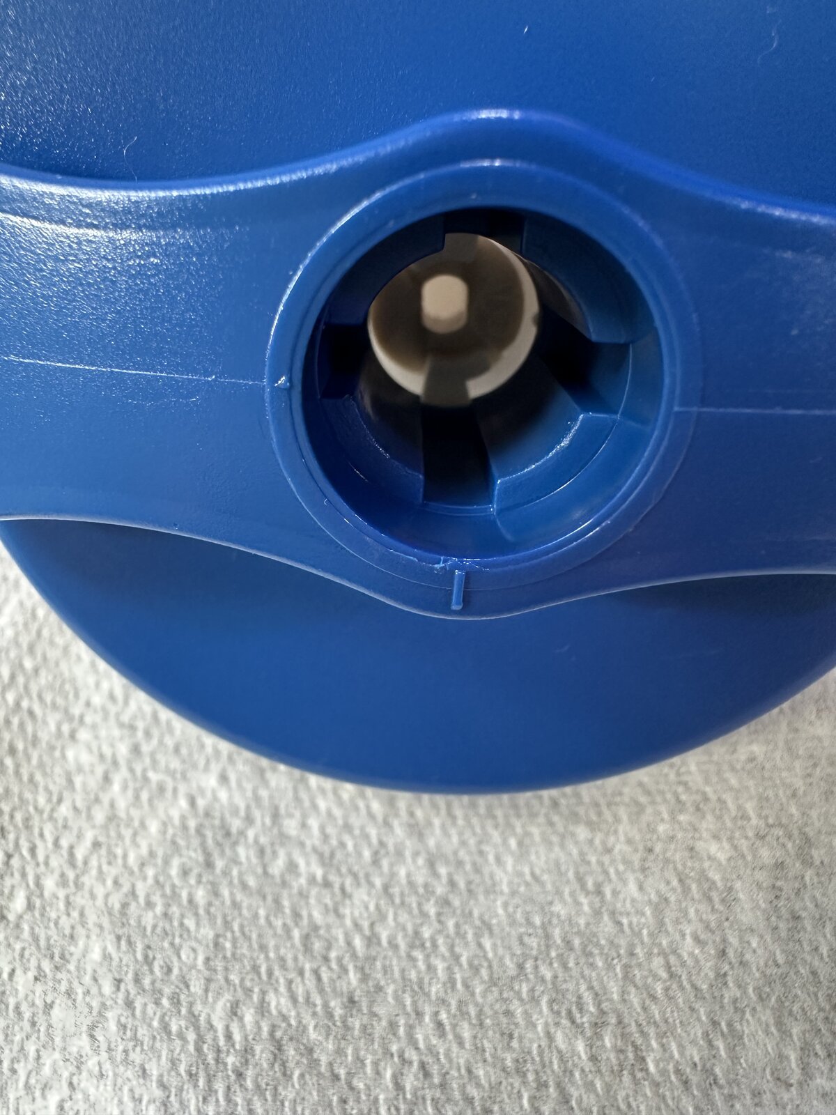

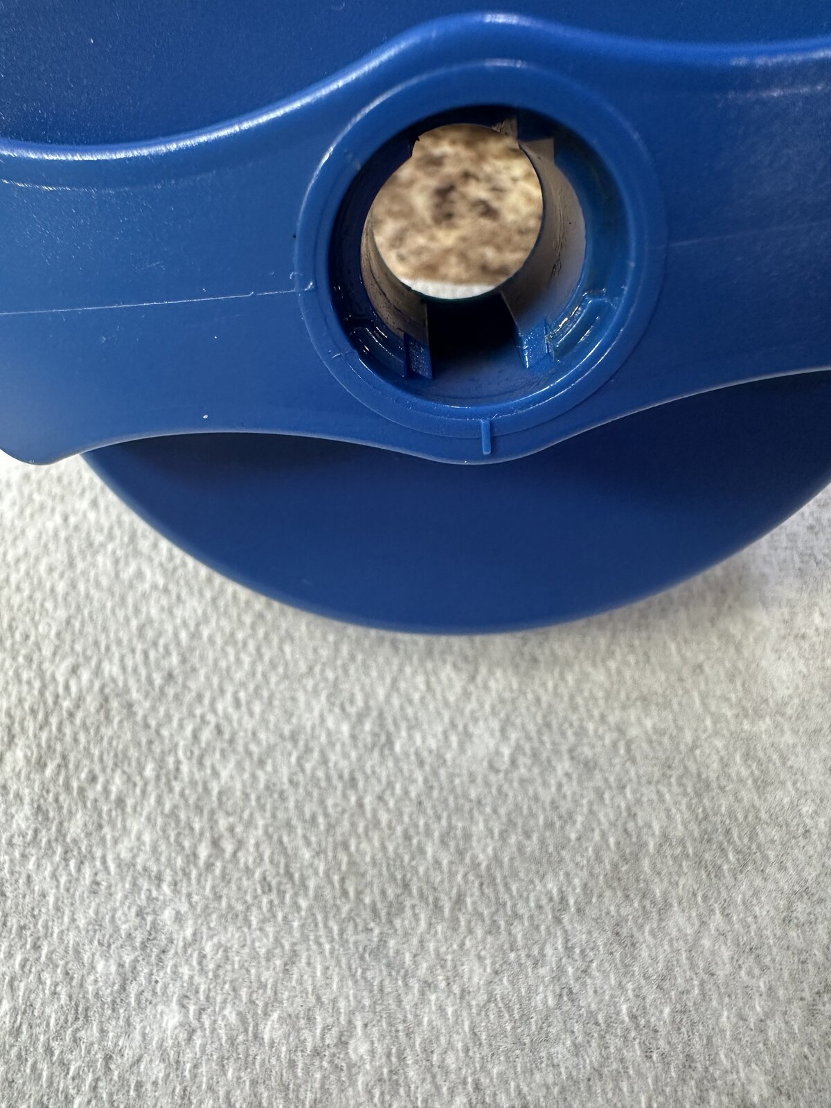

2 lugs have broken on my water filler cap, I got a replacement off eBay without a locking barrel as I wanted to switch my existing one in. Now I’ve found the internals are different. The old one has 2 large recesses and the new one 4 smaller recesses. So the bit you press in on the lock barrel is too wide, so it doesn’t fit. The eBay supplier says this is all they have. I thought I had a Zadi barrel, but maybe not. Does anyone know what cap I need. I don’t want an extra key. Ta very much.
Old cap
New cap

There are different barrel fittings. I contacted Brownhills (they have a store on eBay) and they helped me get the right one.
Mine was this one eBay (not Zadi) but yours could be different depending on the year.

Thanks. The lugs are broken on the original cap. I’m trying to get the old lock into the new cap with lugs.

Thanks very much for that. I maybe should have said it’s for a Hymer, I’ll see if this is the same. Of course it’s twice the price of the eBay one.

StillGoing I have ordered from Brownhills. Thanks to all for your help.
I found the barrel was quite tight to get in the cap but, once in, the cap has been great. It seems sturdier than the previous one we had.

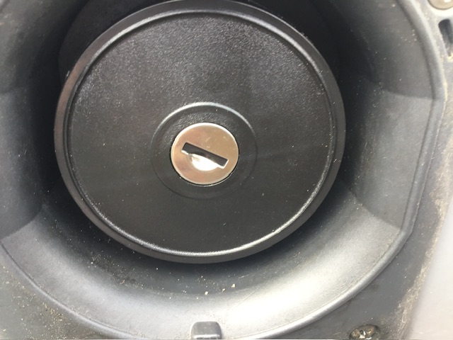

This is a FAR superior lock for the diesel tank ,no pushing and turning to break lugs ,just turn key and lift straight out 👍and easy to fit in 10 minutes 👍👍

Ah I see ,that was the case with my van and from my post above you can see why I was keen to replace the water inlet lock😵‍💫 I then had to change the diesel cap as I broke one of the lugs(stupid design) ,when I priced up an OM replacement it came to £££ which is why I installed the lock above ,much much better👍(about £25)
