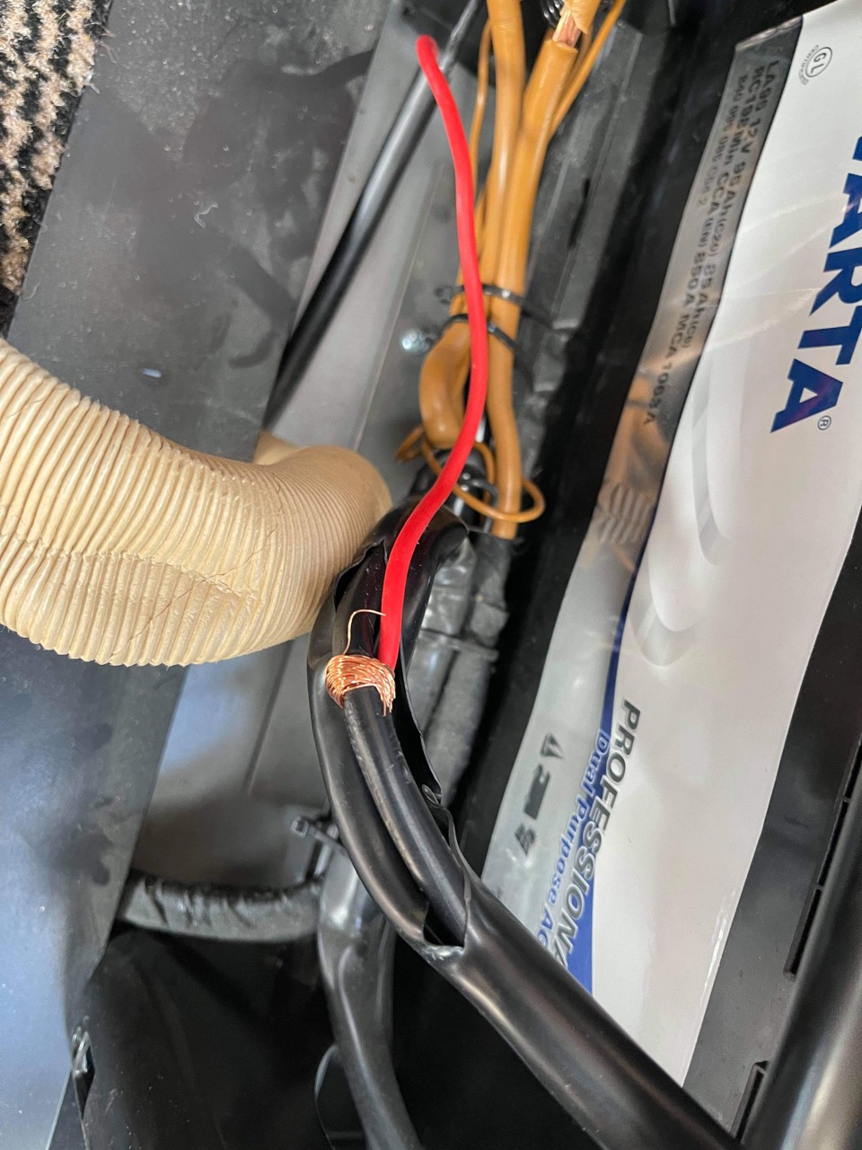

A friend of mine had a solar install on his Ducato PVC at a workshop in Preston.
The installer thought it’d be a good idea to strip back the insulation on the battery cables and wrap the solar wires around. He did use black insulation tape though so probably thought it’d be fine.
We have rectified the bodge by removing the seat (4 bolts) and crimped 2 ring terminals on which is how it should have been done in the first place.

To start with the wires are undersized, probably used thin walled cable which is sized differently the mm sq includes the insulation.
More importantly connecting like that is a very high fire risk, no way could you get a decent connection and it would be prone to arcing.

Have they fitted many other solar systems, or even any , no qualified electrician would do that if he wanted to keep his job
First port of call for me would be trading standards because that falls well short of a professional installation
It makes you wonder how many vans are driving round wired up like that , vibrating , going over speed bumps
You can only hope it was meant to be temporary to test the panel was working then soldered and heat shrink applied and he forgot to do it

I have offered to sort all the wiring out on the van and my mate is happy for me to do it but he wants a report on the install first.
