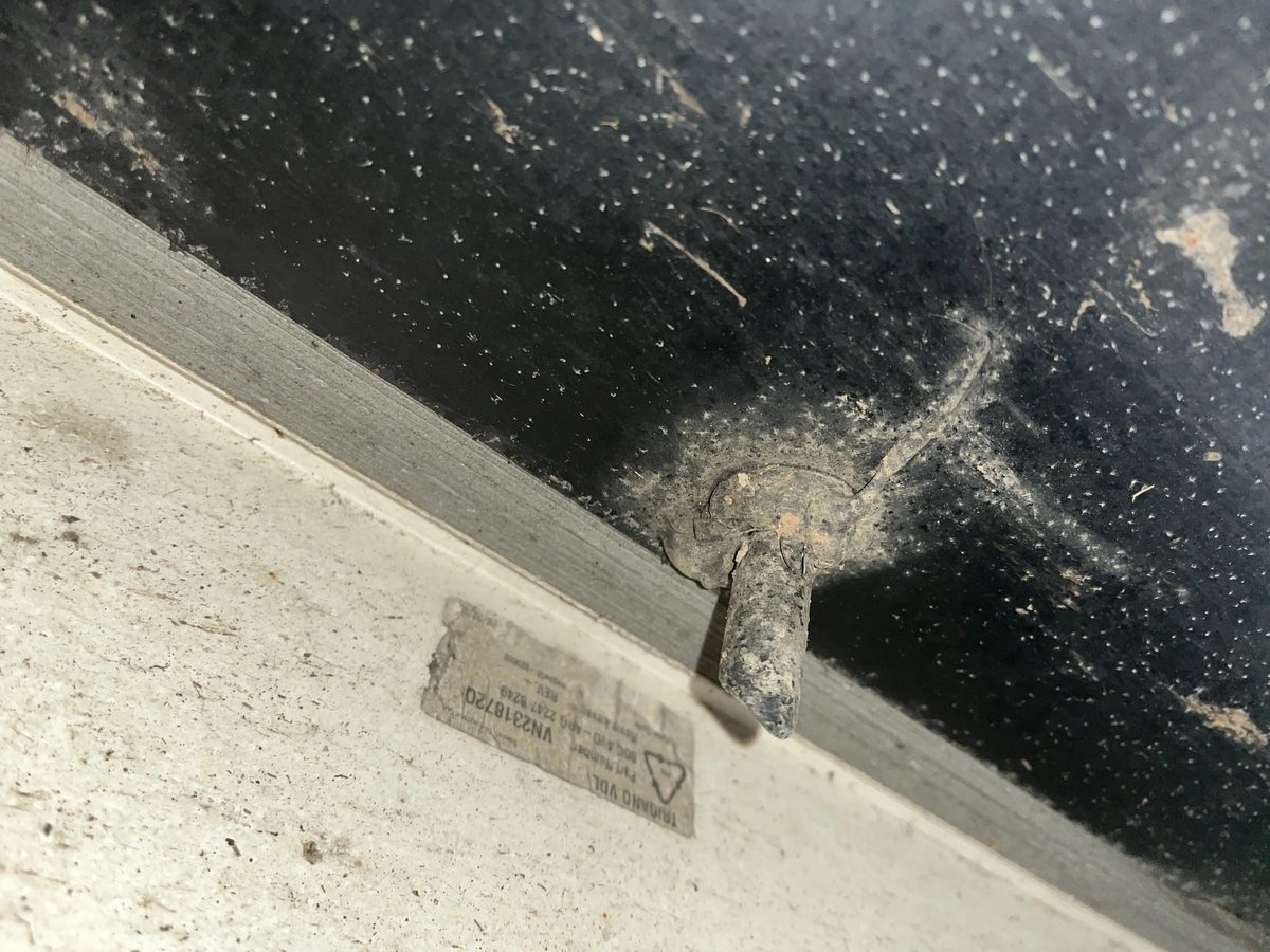

Inspired by my new found technical prowess, I shuffled underneath my motorhome. We’d not done this before. Here’s what I found beneath the frost valve:
It looks as if it is, indeed, missing a pipe, and this does explain why water looks like it’s water falling from the body of the motorhome. Instead, it’s just washing down the fibreglass and won’t cause any damage. The new pipe from Truma will direct the water straight down.
