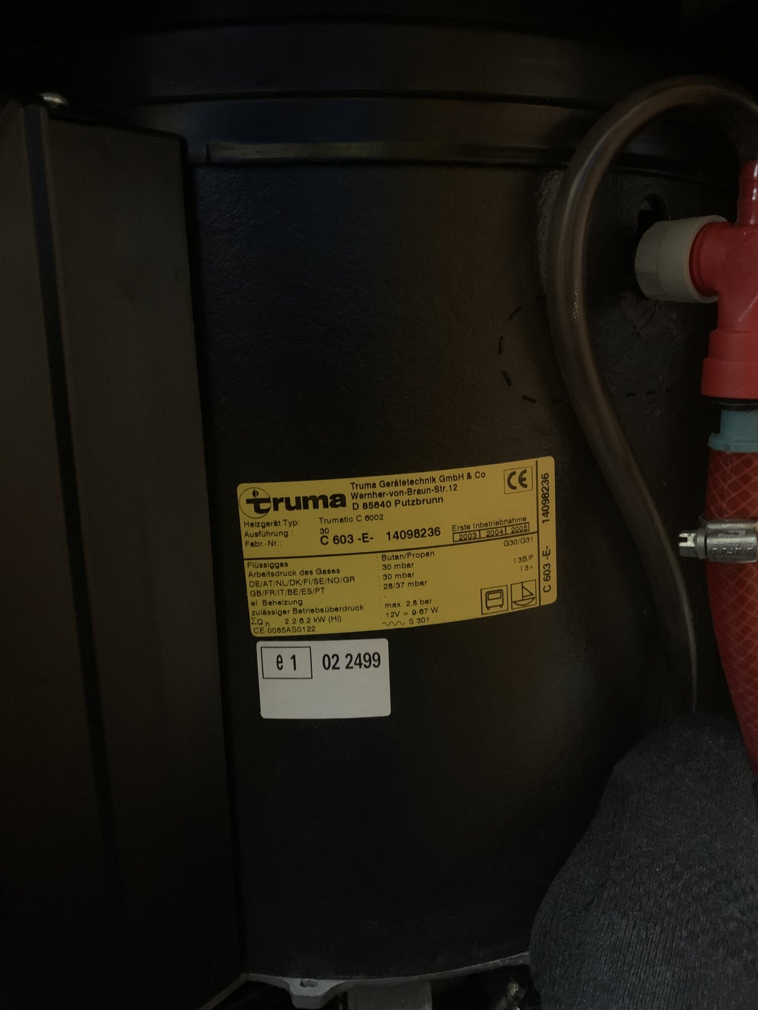

Hi I have the attached file Trumatic C 6002 on my 1995/96 Hymer B654. Part of the attached label also shows the years 2003,2004&2005 spaced out horizontally next to each other.
There are also larger letters that state:
C 603 -E- 14098236.
Can anyone recommend anyone that is competent in all matters dealing with this?

Sorry, I am still confused over what you mean by blowing air. Are you trying to prove air can flow through the ducts ? Reading your original post it looks like the fault you are trying to address is it will not light. You mention 'just before the gas flows, it turns itself off'. How do you know the gas has not started to flow? You could be chasing an ignition fault, a flame detection fault, a gas valve fault or even a control module fault. Do you have a red light warning on the control panel?
Yes, does have a red light. Need an engineer really I feel. Though would happily do myself
