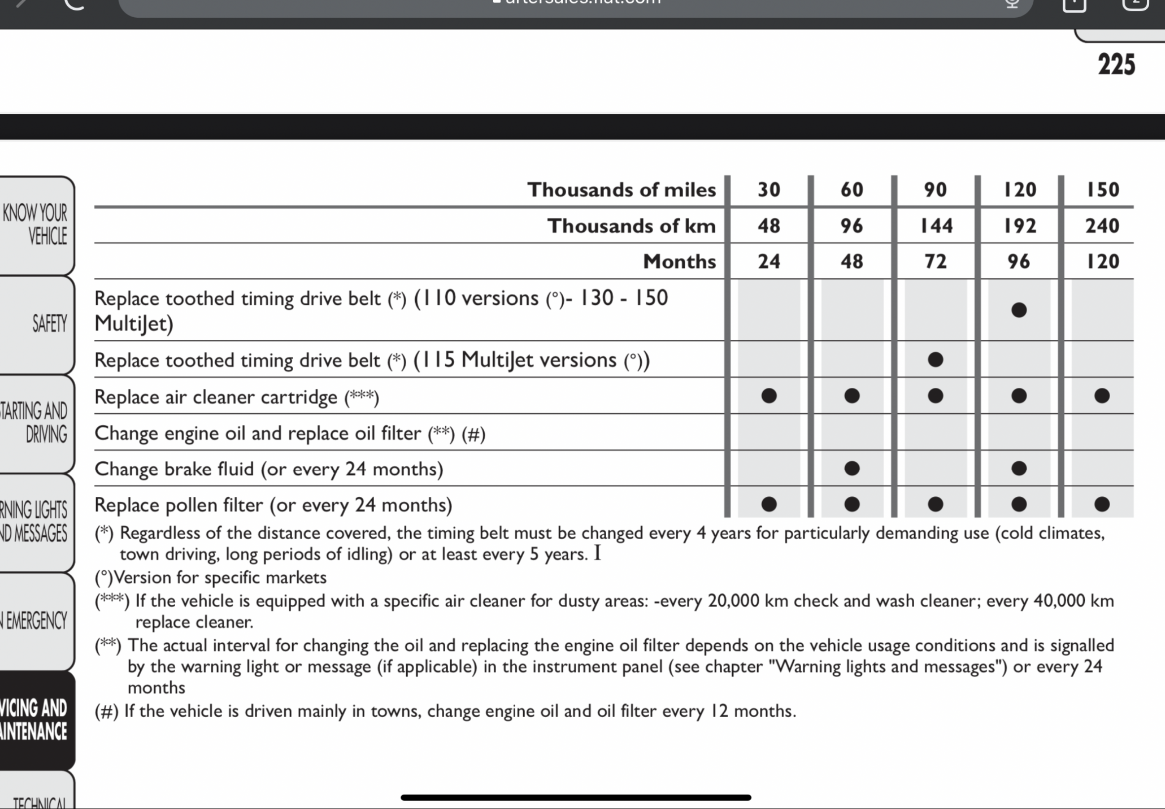

(*) says 5yrs

If you read the line about the timing belt in the table it states 96 months, the * refers to vehicles used in cold/demanding climates when 4 years is recommended but at least every 5 years. Thus the question is does the type of use most MHs have come under * or the table? :unsure:
