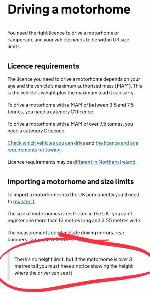

I used to think that but Is it though?
OMG ?..... I hope I’m not breaking the laws that I upheld for so long ?
I’ll do some digging, but at first glance at the link you provided, it reads that it does apply to all vehicles.

Interesting (if I'm reading it correctly) that the height displayed must not exceed the travelling height by more that 150mm.
Jim
I’ve dug as far as my limited resources allow and the verdict is that everyday continues to be a school day.
I’ve looked at a few bits of legislation, where this applies across the board and not just to commercial vehicles and drivers.

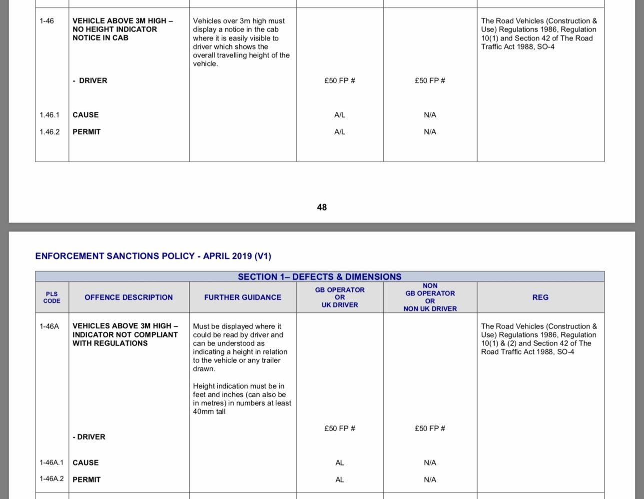

I wonder how many motorhome owners/drivers have stuff on their vans that like me, take them over 3 metres and don’t have the 40mm high warning displayed, in feet and inches, risking a £50 fixed penalty (from DVSA prosecution guidelines)
View attachment 337001View attachment 337002
Interesting, One would assume, that the Importer/Dealer/First Owner. Would have been aware of this regulation?. I like many, would have assumed that it applied to GOODS carrying vehicles only.? I had them on My R-V`s. Over 7.5t. But not on the current vehicle, of which I must admit I have as yet not Checked the overall height
