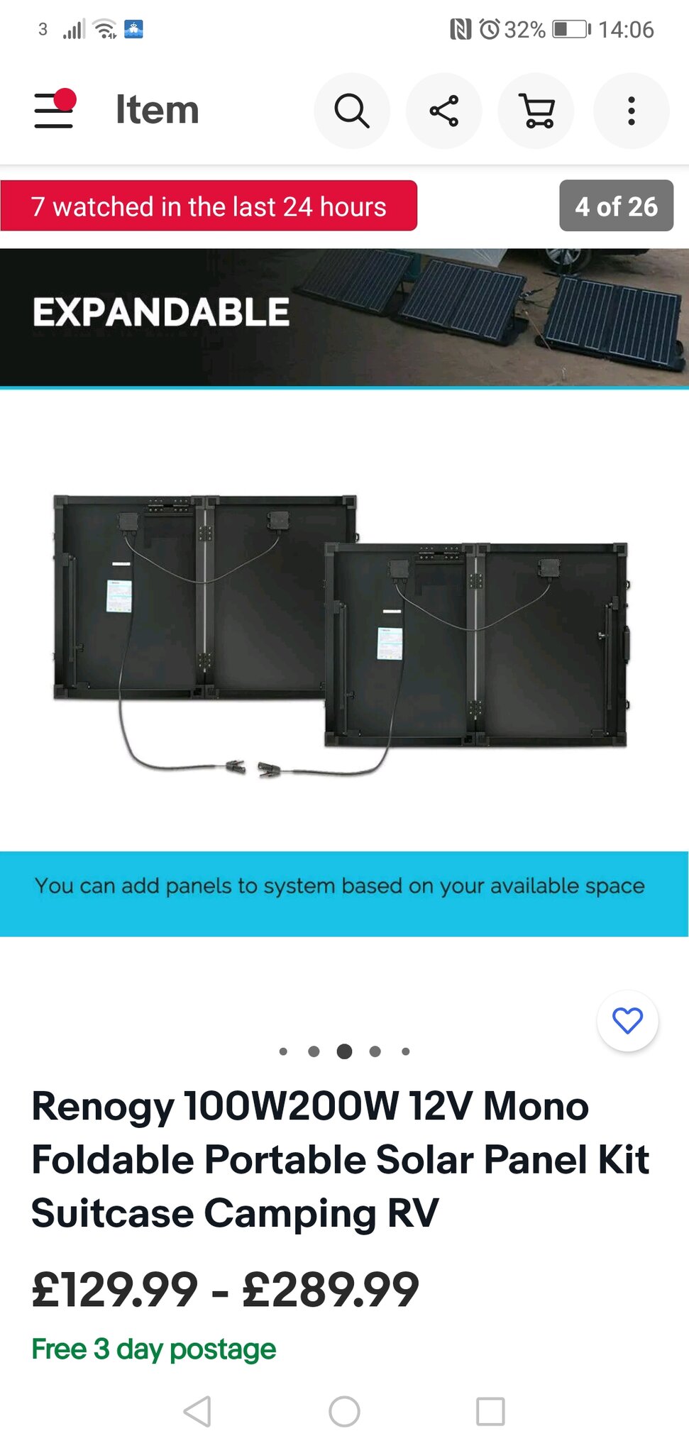

The suitcase panel comes with crocodile clips to attach to the batteries.
I would like to hardwire from the batteries under the floor to a plug, cut the crocodile clips off and replace them with the other plug end.
Any suggestions for a suitable waterproof plug ?
Amperage is only low, less than 10 amps.
Mc4 connectors.
Ah, just realised you will want them waterproof when not connected...
I guess.
I've put these on our battery maintainers, they are waterproof when connected but when I disconnect the scooter one I've made a blank plug out of another plug which I just sealed up with silicone.
Would a 10amp plug be high enough amperage ?
Theoretically the solar can deliver just over 8 amps although from what I've read in full strong sunlight 6 amps max is more realistic.
Should be OK as long as the cables aren't too thick to crimp in.
You might be better off with MC4 connectors and make some blanks up for them.

You're supposed to connect the batteries first but it should be OK if supplied like that. It would be better installed next to the batteries though because of the slight voltage drop... Unless it's been compensated for 🤔
These
I wouldn't use MC4 connectors for anything that needs to be plugged in and unplugged regualy. They are a pig to get together & get apart that's why they are such a good waterproof connector.
Andason plugs & sockets would be better.
I'd thought of Anderson plugs but are they waterproof ?
I didn't used to click them together fully when we used the free standing panel, it only made 2.5 amps though.
while i agree with Lenny that without the tool they are very difficult to disconnect. if you use the correct tool for Mc4 they are easy to take apart and the tool costs pennies.
i purchased 5 Mc4 connectors and 2 tools from amazon for around £7.
the other point i would make is that you plug in to the batteries before opening the solar panel out.
if your worried about the anderson plug being waterproof buy a spaer plug to insert when not in use
