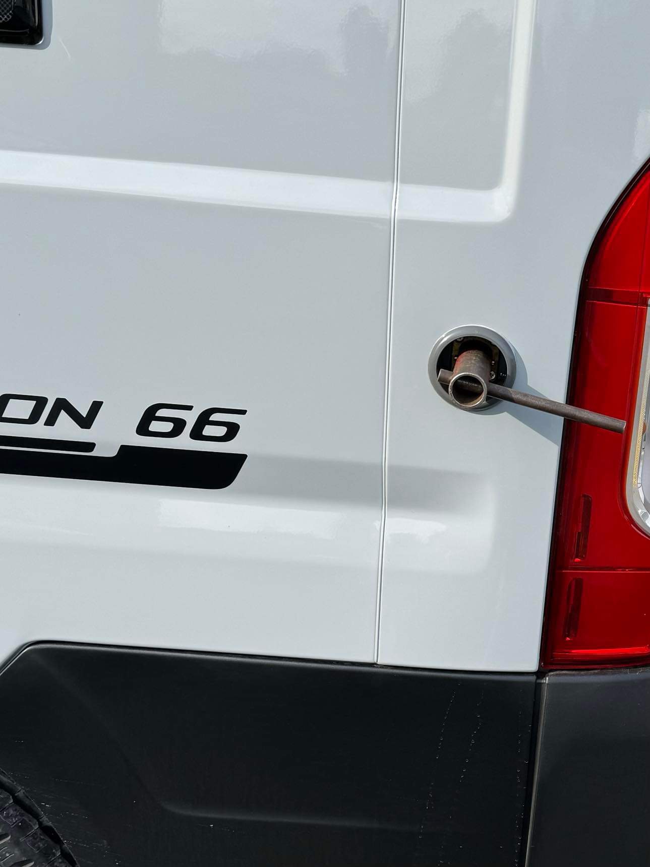

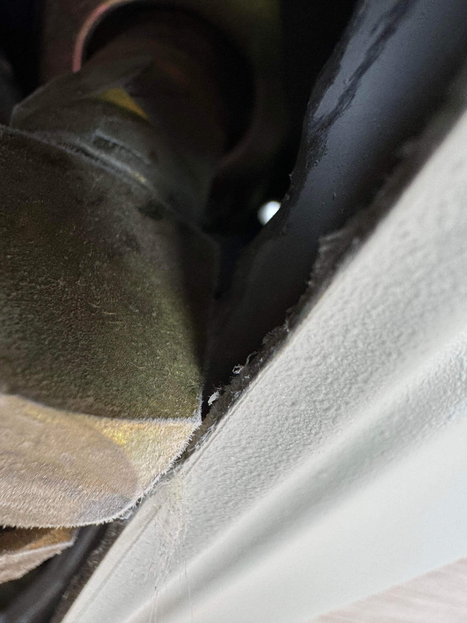

So a customer presents their van to us yesterday with what they thought was a possible overfilled refillable gas cylinder.
Turns out a dealer fitted system had a leaking filler hose as they decided in their wisdom (or perhaps lack of it ) , to install the filler. In the side of a panel van conversion, using poor quality fittings and not vented to outside with vent hosing as required, at least 4 litres of LPG in liquid state into the void between the outer and inner skin , so approximately 1,000 litres of LPG in vapour state ⚠️

Basildog in his OP said that the vehicle was presented to him with 4 litres of liquid LPG in a void, with photograph, so it had not gassed off by then.
Turns out a dealer fitted system had a leaking filler hose as they decided in their wisdom (or perhaps lack of it ) , to install the filler. In the side of a panel van conversion, using poor quality fittings and not vented to outside with vent hosing as required, at least 4 litres of LPG in liquid state into the void between the outer and inner skin , so approximately 1,000 litres of LPG in vapour state ⚠️View attachment 871903View attachment 871904View attachment 871905

When I fitted in my cars the filler pipe to the internal boot tank had to be in a separate corrugated plastic pipe that was sealed at the inside end and vented to the outside at the other end. Any leakage in the filler pipe vented to the outside.
Motorhome tanks are usually sealed from the hab area so no separate venting of the filler pipe is required but if the install has some pipework inside it must still be sealed and vented to outside..

Yes he said it leaked 4 litres in a liquid state but he didn’t say it remained a liquid after leaking. I read it to be a way of quantifying the size of the leak, not a comment on what remained after the leak. He went on to say that was about 1000 litres in vapour form. A leak in the filler hose would initially be in a liquid state because this is how it is stored and pumped.

I installed a "boot" and pipe which goes behind the filler into the gas locker, which is then sealed/lipped and a bottom vent hole external - so any leak from filler, fittings to bottle is captured and vented.
the pic shown looks b**dy awkward to get to, tighten and check, and any leak would go into the van and where it wants rather than a set path to exit.
£10-15 in bits - why omit it?
