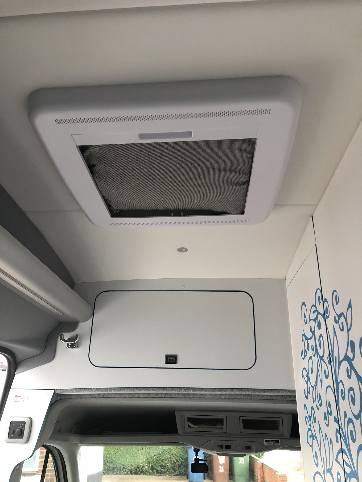

Camco RV Vent Insulator and Skylight Cover with Reflective Surface, Fits Standard 14 x 14 Inch RV Vents (45192)​
  1. Camco RV Vent Insulator and Skylight Cover with Reflective Surface, Fits Standard 14 x 14 Inch RV Vents (45192)
  2. Is this an option for keeping OUT the cold and heat or will it compromise airflow and ventilation?
  3. Thank you...

I wouldn’t want to leave it in place for long periods - perhaps in the evenings if you’re getting a cold down draft - but remove it during the day for ventilation (with the roof vent open, of course….)

I made a similar thing from a block of foam covered in plastic film. It cost me nothing. I made it to silence the vent when travelling. Most vents were made for caravans where travelling noise is not an issue, then used by motorhome manufacturers without that consideration.

I made up pads from a few layers of silvered bubble wrap insulation bonded together with double sided tape that I fit into our skylights on cold nights, plus it does a good job of reducing the heat in our van when the sun is blazing down on the roof although I leave the skylights open then so as not to damage the clear plastic covers. I also fit pads like these between the blinds and the side window in cold weather.
Not noticed any problems with ventilation as we also have ventilation hole in the floor of our van in the under seat lockers.

The skylight covers are normally to keep out the blazing sun in summer in the south of france (other sunny spaces are available)
Never felt the need to block any skylight because of the cold even in minus temperatures 🤷‍♂️

I would rather not heat the air at the other side of the plastic, if possible.

Thinking more at night in winter months. Would remove in the morning.
If using gas heating.... Don't want to die in our sleep. Is it safe to do?
Very safe to die in your sleep you won't know anything about it. :LOL:
The gas heater is room sealed so no danger.
