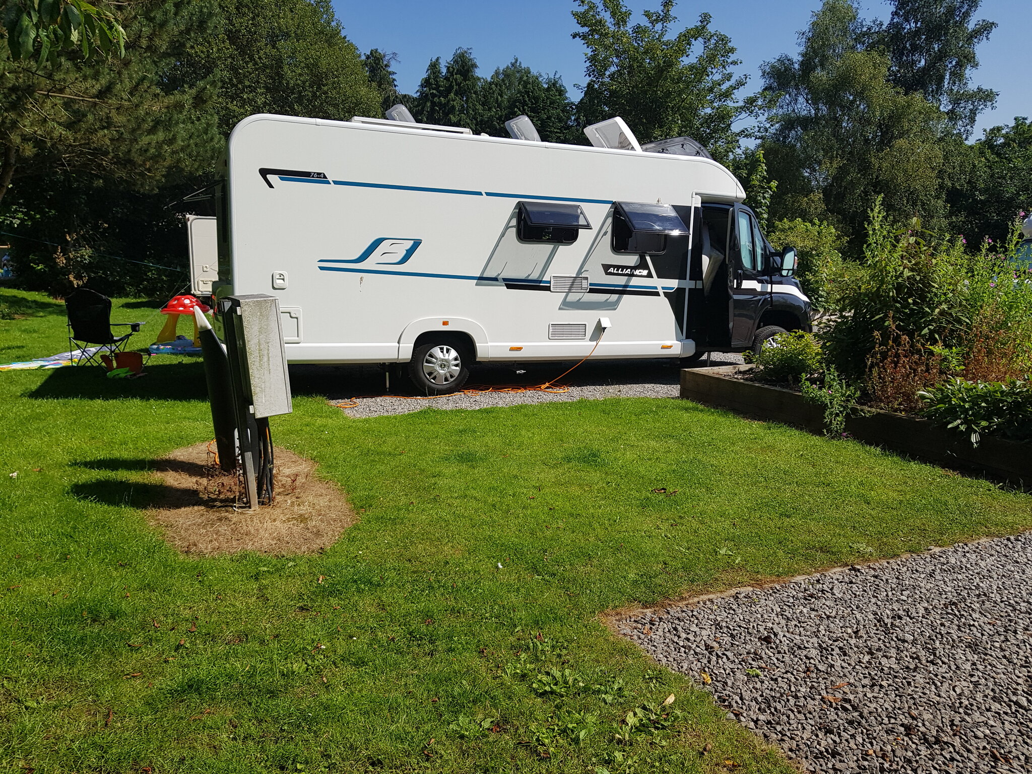

I'd like to think it would work on automatic on a plot like this , unless I'm one of the idiots you speak of !
I've had it working fine on land across the road from my house , and that was on quite a bit of a slope , the times it's done this , you'd think it was very flat and level.

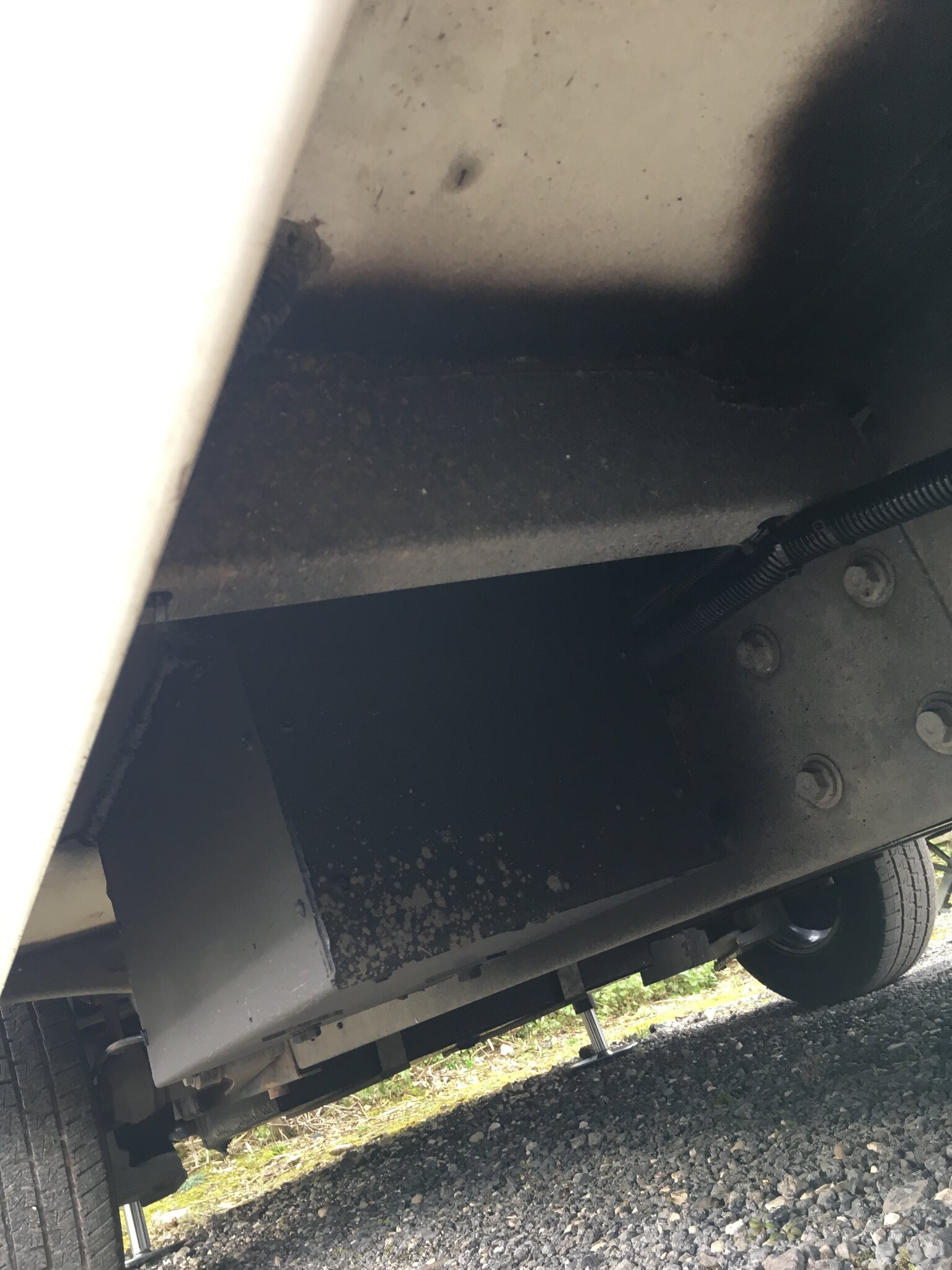

I'm wondering if there is an issue with the sensors in the system

I can understand the system crying foul if the the vehicle decides it can't be levelled with the rams at full extension but Ian seems to be saying that he can level it under manual control (no mention of blocks being added). If the jacks have sufficient extension to get it level, I don't understand why it can't do it automatically. If I'd just paid more than 5 grand for a system that is advertised as offering automatic levelling I don't think it's idiotic to expect it to work unless the rams don't touch the ground on full extension - which doesn't seem to be the case here. Surely there's a fault somewhere?

Have you looked at my photos above of the pitch ?
I don't think they could get chipping any more level , and it still doesn't work
Looking at how far your front suspension is extended and the back end is settled, then there must be a reasonable slope would you not say ?
Maybe you do have a problem or the system was not set up correctly by the installer ?
I’m wondering if the Auto Level position has become corrupted.
You could go into the settings and re set the level position (having first levelled manually to your desired position with a spirit level)
Then try Auto Level again
