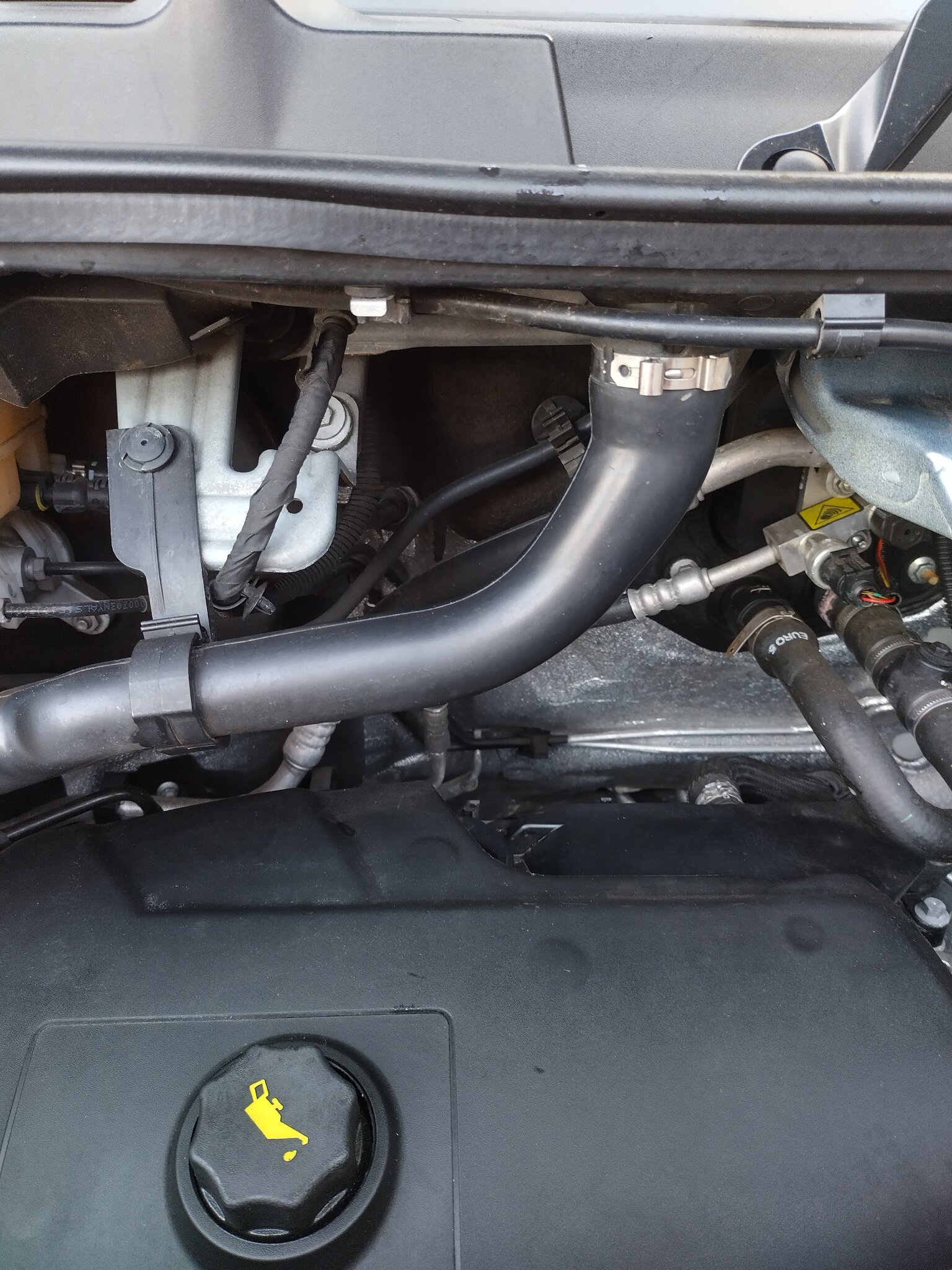

We've been back home just over a fortnight, since when Brunhilde has not moved. In the fading light, I began the under bonnet clean and check and noticed a now bone dry rusty water stain, about 75mm long and 15mm wide on the Rocker Cover. Stupidly I wiped it off before I took photos, but even after the cleaning, there is still a trace of the stain. The drip must have occurred on the drive home from Loch Doon, during a torrential storm, but it cannot be splash related.
The only difference from normal was that I was having to really open the throttle to keep a decent speed into a headwind, so I wonder whether the [slightly overfilled on delivery from the Dealer] coolant escaped from the system somewhere whilst being driven so hard,or whether there is a more sinister problem lurking. Brunhilde is a touch over 5 years old on a Jun 16 plate and has covered 11046 miles from new, 2270 of them since we bought her on 21st April 2021.
The coolant reservoir still looks slightly over full, and there is no sign of any leakage or tell tale dribble stains or runs from any of the hose clips in the vicinity of the stain. The 'dropping zone' for the water looks to be directly under the hose shown in the lh picture but the funnel/entry looks like a drainage channel rather than part of the sealed coolant system.

Water from the windscreen scuttle over flowing ?
Thanks, Clive. Does that mean it's nothing to worry about? Is the scuttle the plastic channel that contains the hose that's clipped to the underside, and which seems to gather water every time the m/home is washed, even though the drainage channels at each side ot the engine bay are free of debris and dead leaves etc?

I get that same. If you lift up the rubber seal running along the bulkhead (forward edge of the water drain off channel, you’ll probably find it rusty), nothing to worry about.

Check scuttled drain pipe rubber hose is connected to the scuttle spigot. And scuttle drain pipe isnt blocked my work van soon gets blocked if park under trees
Yes Steve, as said above drain holes/pipes may be blocked. So nothing to worry about too much. Some have a toggle in them. Enjoy your rally.
Checked the Offside and Nearside Drainage channels and water pours through freely and quickly, so no blockages. The middle drainage hole that has a spigot with the large diameter tube clamped to it, has about a metre of hard plastic casing attached [it shows in at least 2 of the 3 photos] and is joined/connected about 1/2 way down [looks like an aircleaner breather system!] before it disappears into the front of the offside wheelarch, quite high up [going from 'feel' rather than vision.
3 observations/queries; firstly, water travelling from offside towards the nearside drain hole [i.e. the 2 outer drains], skirts the central drain hole, with very little actually entering the centre drain hole [this is the one that sits slightly to the left and down from the nearside windscreen wiper mounting nut in the photo]; secondly, is it intended that water should enter the central drain hole spigot to which the damn great plastic casing is attached? Thirdly, will I do any harm pouring water down the central drain hole, given that I cannot see where the pipe enters the offside wheel arch?

This used to be a serious problem on the X250 model Ducato (and sister builds) however the X290 doesn't seem to suffer the same. If you search on "windscreen scuttle" you'll fine a number of threads.
The water would enter through the central joint and drip onto the plastic engine cover and then "drain" into the glow plug recesses underneath with resultant rusted \ faulty glow plugs. Bu**er to replace!
