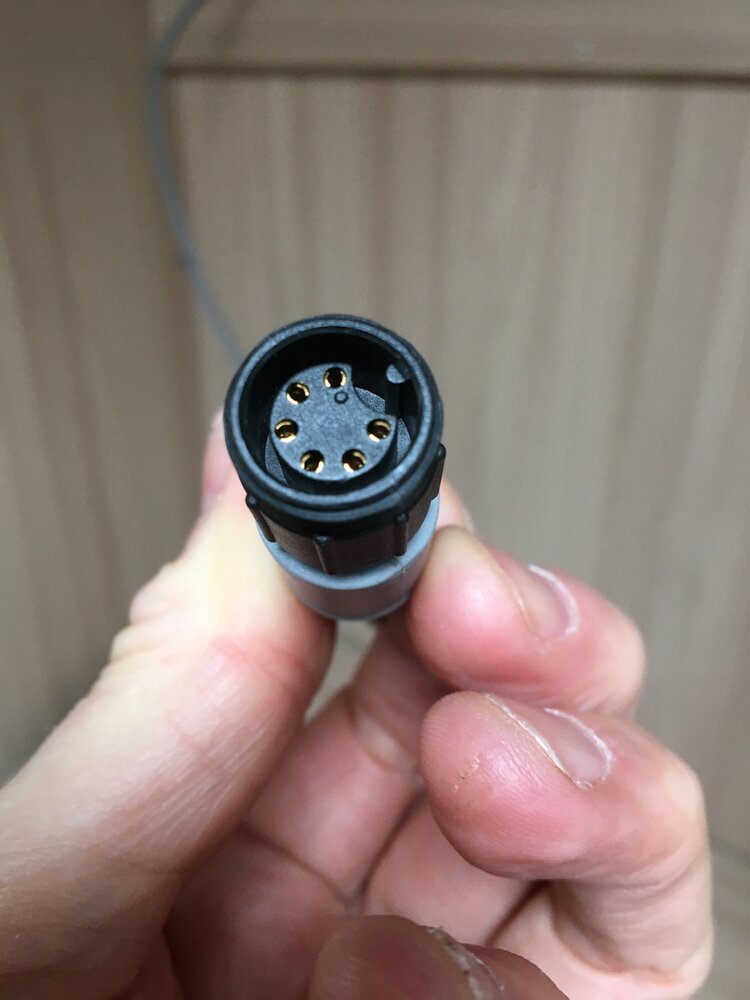

Hi. We have just bought an ace adventurer with fitted in rear camera, I assume I was fitted at manufacture. It has the Blaupunkt Sat nav with it, which is still working as a sat nav, but when we put it into reverse, theres just no picture, sat nan just stays on. Checked connection at camera and at reverse light, and tried plugging AV cable into TV to see if a picture comes up on there, and it doesnt. Looked at buying a new kit to just use camera, but the connector is like a 6 pin with a slot in middle, and it looks like the ones you can buy have 4 pins. I have looked at buying a wireless one, but that still needs wiring to a reverse light, and since we already have all that done and we have no idea what we are doing re electrics, it doesnt seem like the ideal solution. Does anyone have any ideas please? Thank you for reading.

if it looks like this it’s a waeco cable and you can get adaptors If required. BROKEN LINK
The Camera side looks like this, it has a plastic pin/bit in middle. Is that the same thing. I have just bought a connector to put on the end attached to the van and I can put a USB into it, I'm hoping I can get a camera with a USB cable????

It looks like an old PS2 style connector on you camera.
Have a look here or speak to them regarding adaptors to fit different styles of camera connectors.
