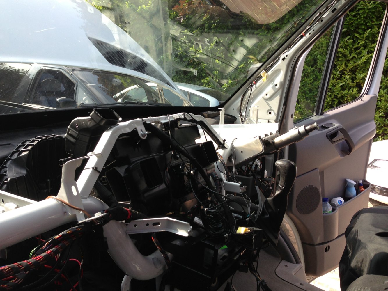

If you have a good size alternator (sprinters usually do (as high as 280a)).
Go for a roof mounted. Best of both worlds.
I have retrofitted cab a/c to a sprinter myself. Huge massive job with entire dash and steering having to come out if you use certain kits

Good evening eurotrotters,
i know you posted this awhile back but would you mind telling me what is needed to complete this instulation i am in the motor trade myself so dont mind doing the work.
For The Sprinter you will need a retro kit.
The Evaporator is probably the easiest part. You will need a compressor, new bigger belt, condenser, expansion valve, drier, Lots of piping and switches for the interior.
