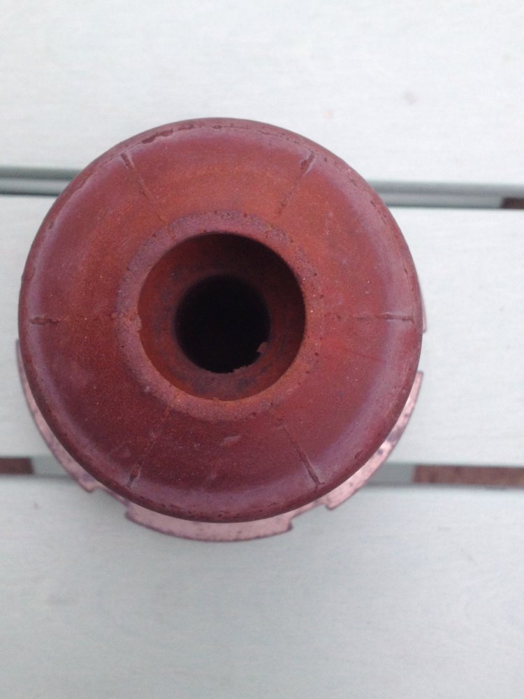

I removed mine and fitted Dunlop air suspension but kept them just in case!
Here are two photos to show that they are hollow!
@Geo Does this help you determine that they are not bump stops?
View attachment 144629 View attachment 144630
That's not a Bump Stop it's a DILDO
img_2990-jpg.144629
